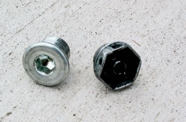

    Thank you. Drain plug is the one on the left I believe?

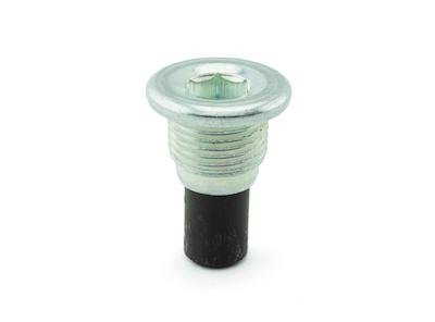

    Those are factory parts, the 18035 has multiple apps. The hex works well on the axle drain as it is smooth and doesn't easily become chewed up. A dab of grease or rust proof spray wax keeps them all steel and easy to remove.
    If you want to stay with the 24mm type, order a 90341-18040.

    Wish we had this post started a couple weeks ago when I set out on my own to find this plug using the TW search bar. I was unsuccessful.... changed my rear diff oil yesterday and reused the original plug with a new crush Washer.
    I know it’s not the plug on the right in this picture. (Part 90341-24014) Ordered it thinking it was the right part. It’s sitting next to the original rear diff drain plug...
    what did I order???

    FWIW, I dislike the stock 24mm hex bolts (like on the right). They round off, they get boogered on rocks, junk builds up in the guard ring so fitting a socket get tough. I've had a corner of one get caught on a rock and loosen enough to weep gear oil.
    So I replace them with the 10mm Allen key type (on the left).
    These are internal Allen key plug numbers:

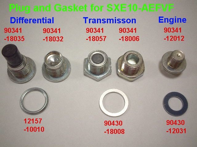

    Drain (magnetic) plug: 90341‑18021
    Fill (non-magnetic) plug: 90341-18016
    Gaskets are the same regardless.
    Crush gasket for aluminum (transfer case, manual transmissions): 90430-18008
    Crush gasket for steel (diffs): 12157-10010
  12. Mar 1, 2020 at 5:10 AM

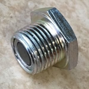

    The original small magenet 24mm is a 90341-18057.
    Small magnet 10mm hex is 90341-18021
    Large magnet 10mm hex is 90341-18035

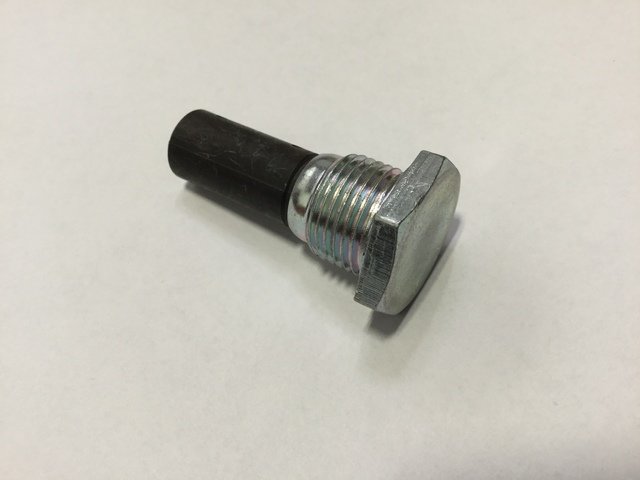

    90341-18021 is the round one with the 10mm Allen and short magnet.
    90341-18057 is 24mm hex head with a short magnet.
    90341-18040 is 24mm hex head with a tall magnet.
    90341-18035 is the 10mm Allen key with a tall magnet.

    That’s my concern as well. If the stock one is short probably best to stay with the short, in this case 90341-18021.

    They will fit the drain, in the past, Toyota spec'd the 18040 for various Land Cruisers and a few mini trucks.
    Of course, if you want to try and bottom out, there is always the porno sized 90341-18044 from the old 90's twin turbo Supra.
