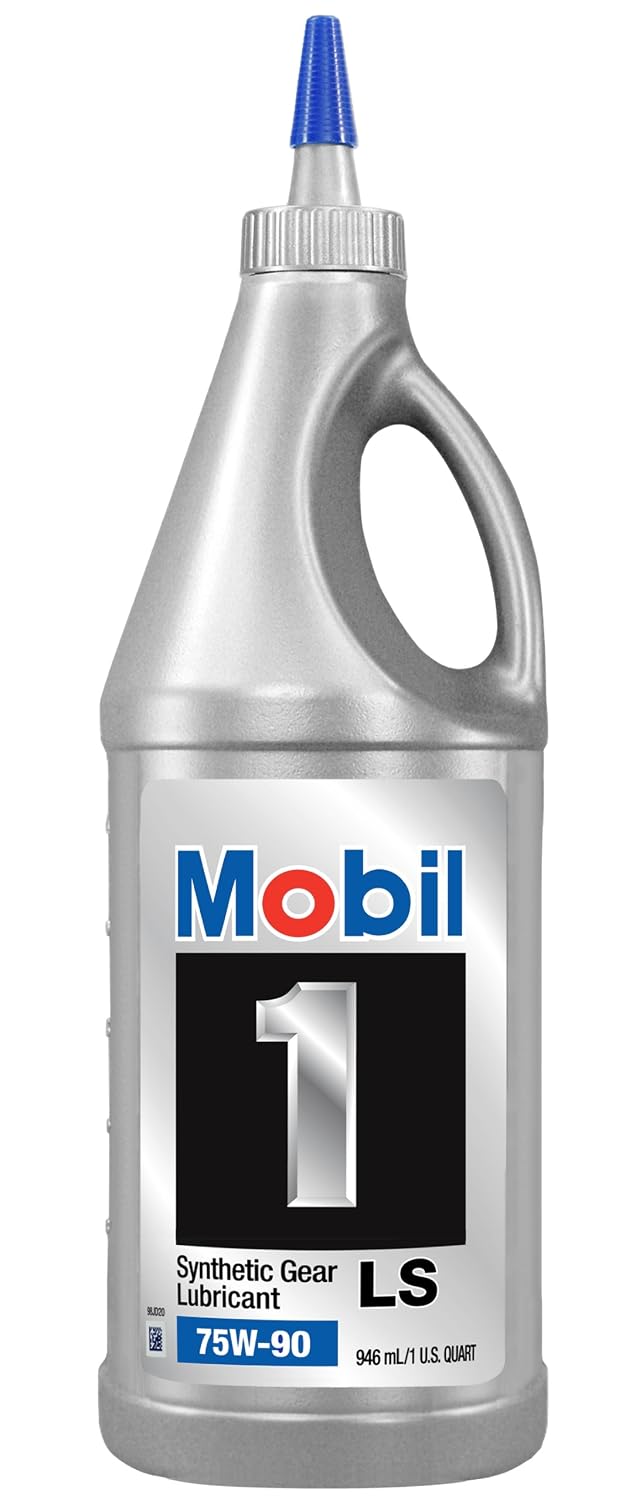

    I run 75w90 mobil 1 ls. Get it at aap with online coupon, like 9 bucks a bottle

    Don't mean to hash up and old thread but I want to change out my front and rear Diff's fluid, I have a 2015 TRD Sport 4x4 and am going to use the Mobil 1 like I did last time, but forgot which one I need. And do I need new gaskets and such?

    I just use 75-90 mobil 1, and I always replace the crush washers

    No, you don't need to worry about it. IIRC the only ones that need that are earlier sports that have the mechanical LSD.
  18. Oct 28, 2017 at 12:14 PM
    #18
    Unchained 5150
    Unchained 5150 Rick
    Sep 25, 2014
    #139054
    65,410
    Rick
    Auburn Ma
    2021 TRD Poser Pro Manual.
    So get the bottle that doesn't have the LS on it?
  19. Oct 28, 2017 at 12:15 PM
    #19
    EatSleepTacos
    Mar 24, 2015
    #151688
    59,770
    Randy
    West Valley, AZ
    2017 4Runner
    I'm running that stuff now and everything has been fine :notsure: Doesn't necessarily mean I'm right though :help:
