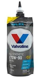

    I've always used the mobile one 75-90 stuff but I'm sure this is good too
