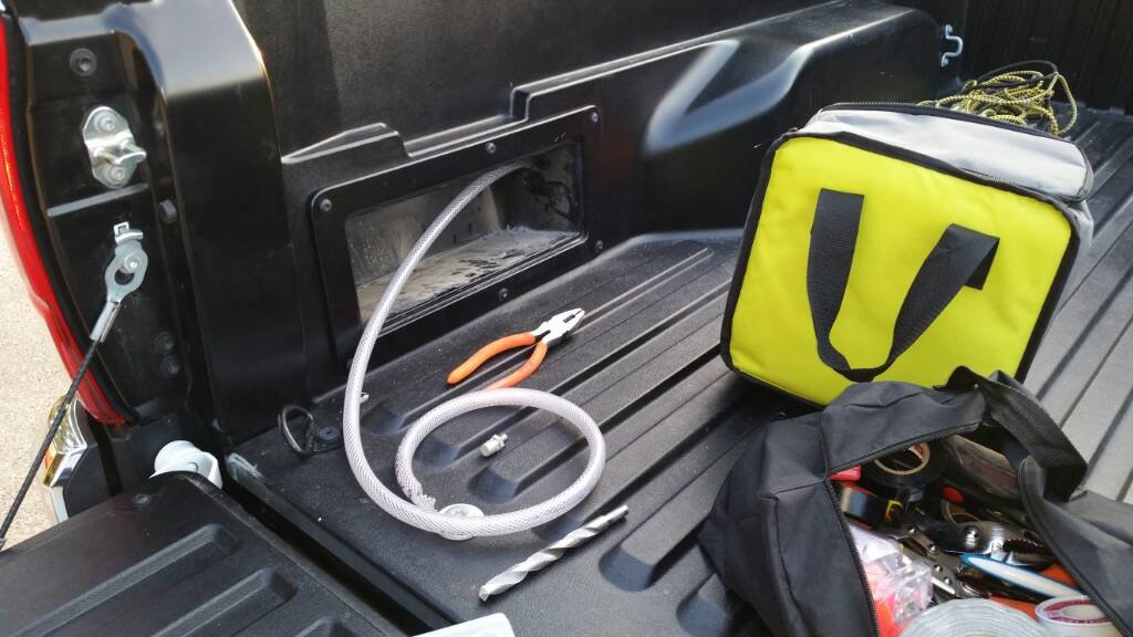

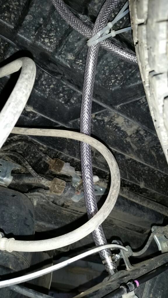

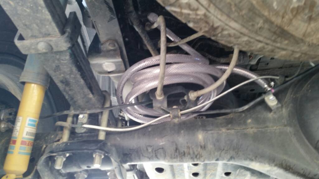

    I am doing the breather mod right now and the valve is not one way. It uses gravity to keep it sealed shut from entering but if you shake it, air is able to run in.
    I'm still working on it.
