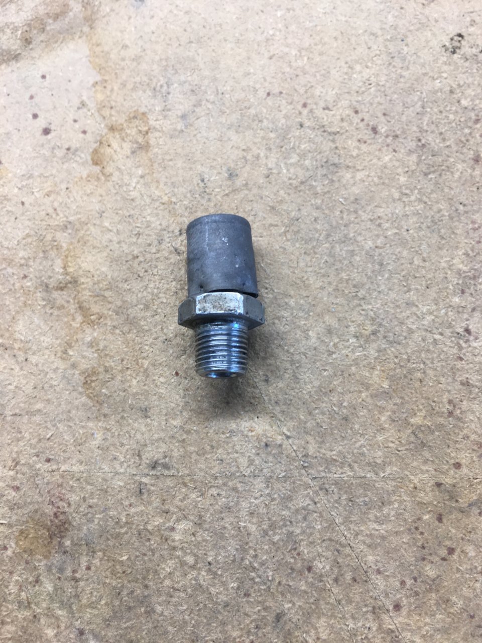

    The oem part number I bought was union 90404-51319. Attached is a pic of the bag the replacement unit came in. Also attached is a pic of the adapter I took out. I have a 2017 tacoma. It did not thread in funny or tight or akward. It went in with the same force that the old one came out.....

    You stripped the threads on the new union. The new part is aluminum, and is relatively soft metal compared to the old part, which is steel. I did the same thing the first time I installed the new union. I was able to get it back out, and bought a second one to replace it. FYI, stripping the threads on the new union did not damage the threads on the diff housing.
    The part can't be threaded in all the way to the flange without stripping the threads, as it is taper threaded, and not originally made to fit specifically this diff housing. The thread pitch and taper is correct though, just not the length.
    I would keep trying to unthread it out while pulling on it, and hopefully the part will eventually come out. Just watch the torque more carefully with the second part/attempt, and you should be fine.

    Cinch a vise grip on the top edge of the breather just enough to get a good grip on her, then pull up as you turn to back it out of the diff. It'll come out
    Put your wrench on the hex of the breather before the vise grip
