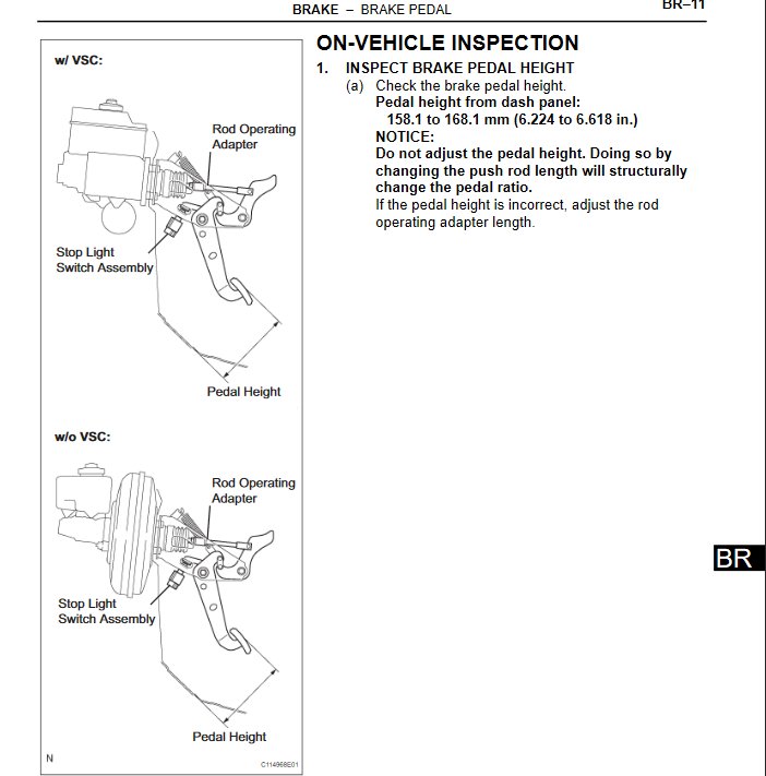

    This may help to properly adjust the Stop Light Switch, From the Service Manual ( See Step # 2 : Adjust and Inspect Stop Light Switch )
    Cheap Taco and TnShooter like this.

    161
    2001 Tacoma Limited Double Cab
    Sweet, thank you! That is what I need
