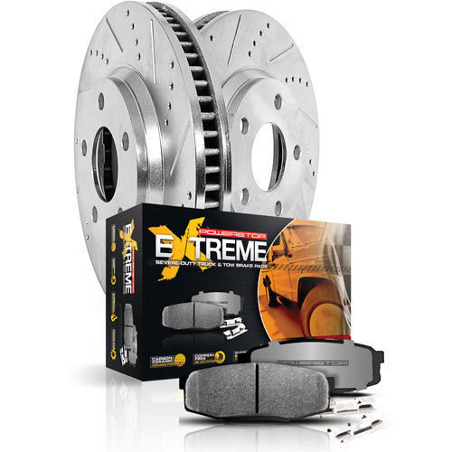

    I just got my taco not that long ago, and I'm slowly starting to replace everything. The truck takes a lot of distance to stop, so I'm going to pick up some "POWER STOP Z36 Severe-Duty Truck & Tow" front brake pads and rotors.
    Would I have to replace the rear brake drums, shoes, and springs + hardware as well? I hear it's a real PITA to work on them and I'd rather not spend the money and take the time to replace them if there's no point.
    I have about 82,000 miles on it. It's a 2WD Automatic. I've never towed a thing in my life. I used the truck to move houses a couple years ago so maybe the brakes could be worn from that. Otherwise I rarely have a load.
    Probably a really bad comparison, but my '00 Mercedes E320 sedan takes about less than half the distance it takes the Tacoma to stop on a flat level road. The Benz also weighs about a thousand pounds more than the Tacoma.

    hard to tell what may be going on with your braking, but replacing worn pads and rotors is a good start. I did when i first got my truck and I'm very happy with its braking performance. ...nevery driven an E320 though. My tacoma stops better than my 2001 Saab 9-3 Viggen, for comparison.
    you probably don't have to replace your rear drums. they last for a very long time. if you haven't been hauling a lot they probably have not seen a lot of use.
    start with the fronts and see where that gets you. the Tundra caliper and rotor upgrade might be up your alley if you want better than stock performance. does the pedal feel weird, or is it just poor performance?

    I just put that Power Stop package on my '99 (did the rear shoes as well: 140k odometer). Now that they are nicely bedded, I am quite happy with the improved stopping. Going to flush the old fluid soon, put new flexible stainless brake lines on, so should improve even more.
    On my Audi A3, I put six-pot calipers, with 2-part rotors on, and the power, the POWER of stopping!! :muscleflexing: The Tacoma will never stop like that, but I never drive the Tacoma like I drive the Audi:burnrubber:
