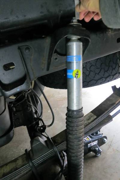

  16. Dec 15, 2014 at 1:45 PM
    #16
    kremer
    kremer New Member
    Dec 12, 2014
    #144165
    2
    twin cities
    09 DC OffRoad
    3+1 Leaf Spring, Bilstein 5100s
    I just upgraded my 09 DC to General Spring's 3+1 HD springs and a set of 5100s. 1.75" in the front and a 2° wedge between the spring and axle in the back and I ended with 2¾" of lift. If you have any chance of going any stronger in your back suspension you should buy the longer travel Bilsteins now, they won't hurt anything if you never do more yet will cost next to nothing to do now.
    My rear Bilsteins came with the wrong rubber bushing in the eye end of the shock. I ground off the excess rubber, ground off a 1/16th" on the included steel bushing, then pressed the steel into the rubber using my vise. I double checked that the shock had the right valving, just the wrong bushing. The Bilstein torque for the top of the shock shaft really didn't seem right to me so I just tightened the nut until I had a 1/4" of stick out.
    I'm quite happy with the results although I wished I'd seem some warnings about driveline judder on the how to posts before I did the new leaf springs.
