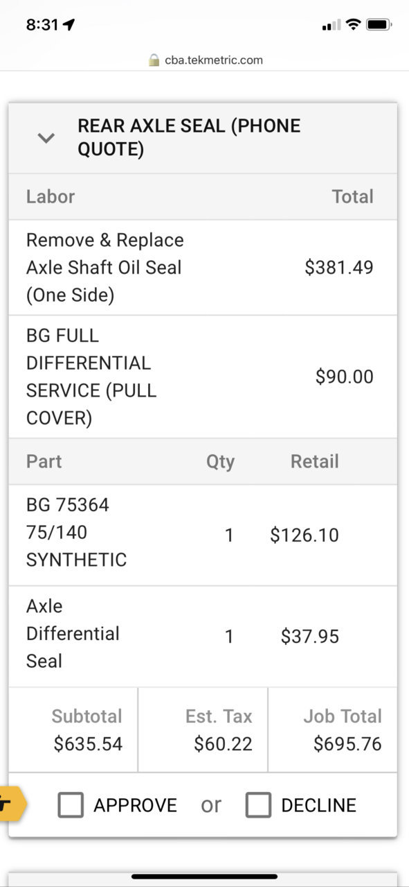

    Does this seem reasonable for axle seal replacement? I guess the main thing that seems off to me is the lubricant…126$ for some lubricant seems kinda steep. Also, the seal doesn’t cost 40$ does it?

    Get another quote.

    Total rip off.

    I just paid 783$ a couple weeks ago to have my drivers side replaced but that included new shoes and turning the drums on both sides since the drivers side was supposedly “oil soaked”. I doubt it was since I caught it immediately as it started weeping but rear brakes had 100k on them so I’m sure it was getting close to replacement time anyways. I’ll take a pic of my service write up tonight when I get off work. The same shop quoted best case scenario cost of just under 400$ if rear shoes were savable. That quote was for seal and bearing replacement and diff service only.
    This was the cheapest quote in my area after calling/visiting several shops. Toyota was the most expensive @ just south of 1900$ for drivers side seal and bearing replacement and new rear shoes.

    estimate is a rip off...

    Oh and that quote is for just one side… oh my!!! My dad said he trusted them and that that’s where I should take it, but this seems a little crazy.

    They lost me when they said "pull cover"
    It's not a Chevy
    That's a little expensive for 1 side only

    Doing the rear axle seal is not nearly as hard as you might think. If your doing the brakes. It’s 4 more nuts, disconnect the brake line and ebrake cable. Pull the axle out, remove seal, install new seal then reverse procedure. Bleed brakes and your done.

    The worst part is dealing with the brake and differential fluid.
    And possibly getting the drum off if it’s stuck.
    I’d fight them on $90 “pull cover”.
    It’s literally a 24mm bolt (plug)That’s it. No way you should pay $90 to remove 2 plugs?
    I didn’t even drain my fluid when I did mine. I jacked up the one side I was working on higher than the other side. This lets the fluid flow to the other side of the axle. And you don’t loose much fluid. So, I’d make sure you go to a trusted shop. As there a short cuts that be made.
    And I personally would not go with the 75w-140 fluid

    Thanks all! I have looked into it more and I think I understand better what needs to be done. I plan to do the axle seals myself, however my retired mechanic friend who looked at it said that the bearings almost defiantly need to be replaced. I think I'll get it all out myself, then take the axles and new bearings to a shop and have them press the old bearings out and new in. Looks like it'll run around $300 to press them. And while I'm at it I'll go ahead and replace the drum brakes as they are toast as well.

    Yea I'd politely ask them to redo the estimate and leave out the " full diff service". That would put it down in the 500$ range which is more reasonable
    If your dad trusts these guys I'd even give them the benefit of the doubt and chalk it up to a possible inexperienced service writer.
