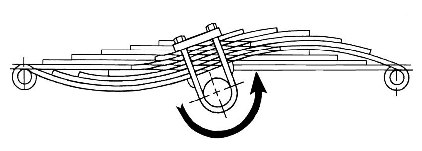

    This is the classic description of axle wrap. The weak, worn out stock leaf pack is twisting with the application of the brakes and the clunk or thump or the feeling of being bumped from behind is the release of the spring bind (wrap) when the brake pedal is released.
    If you do a search of this forum for 'axle wrap' you will find a whole lot more information that may help you fix your situation.
    Here is a graphic description of axle wrap:

    wow nice graphic! something tells me that's what's going on underneath my truck.
    I checked, I have about 1/2 inch of play, not sure if this is normal "lash" or not.
    I plan on bringing into my buddies shop on Tuesday to see what the hell is going on. I think there are some leaf springs in my future. I looked at them a bit ago and they are flat with some negative arc.

    This, sounds like classic axle wrap
