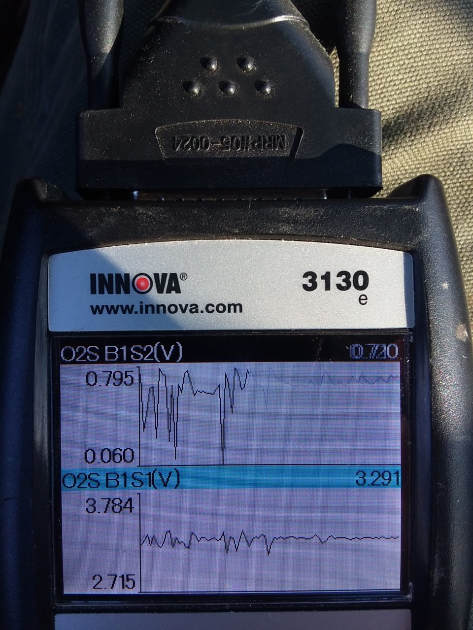

    well my scanner(which i really don't know how to operate) shows that my engine coolant temperature is 201 after warning up such I'm inclined to believe. So probably not that.
    this scanner can show two live graphs at once so i tried to get it to show me the upstream and downstream sensor values at once. i THINK that's what i have here but not sure. anyone who knows how to read these things please let me know.

    i watched this video and i realize that my o2 sensor is NOT doing what it's supposed to. it switches but pretty slowly and on the freeway at higher rpms it isn't switching using the full spectrum of voltage. it sometimes just fluctuates a few milivolts.
    so im gonna order a new o2 and see what that does!

    If the rear O2 does not cycle it could be bad... with a small propane torch introduce propane into the intake AFTER the MAF and preferably after the throttle body and watch both 02 sensors. The A/F sensor is going to change pretty quick then the rear should start to move. If it doesn't, the rear o2 could be stuck rich. The sensor not switching fast enough is more than likely the very limited sampling rate of the tester and not the 02 sensor. The front A/F sensor is the input to the PCM to change the duty cycle of the injectors for a rich/lean condition, the rear 02 monitors the cat.
