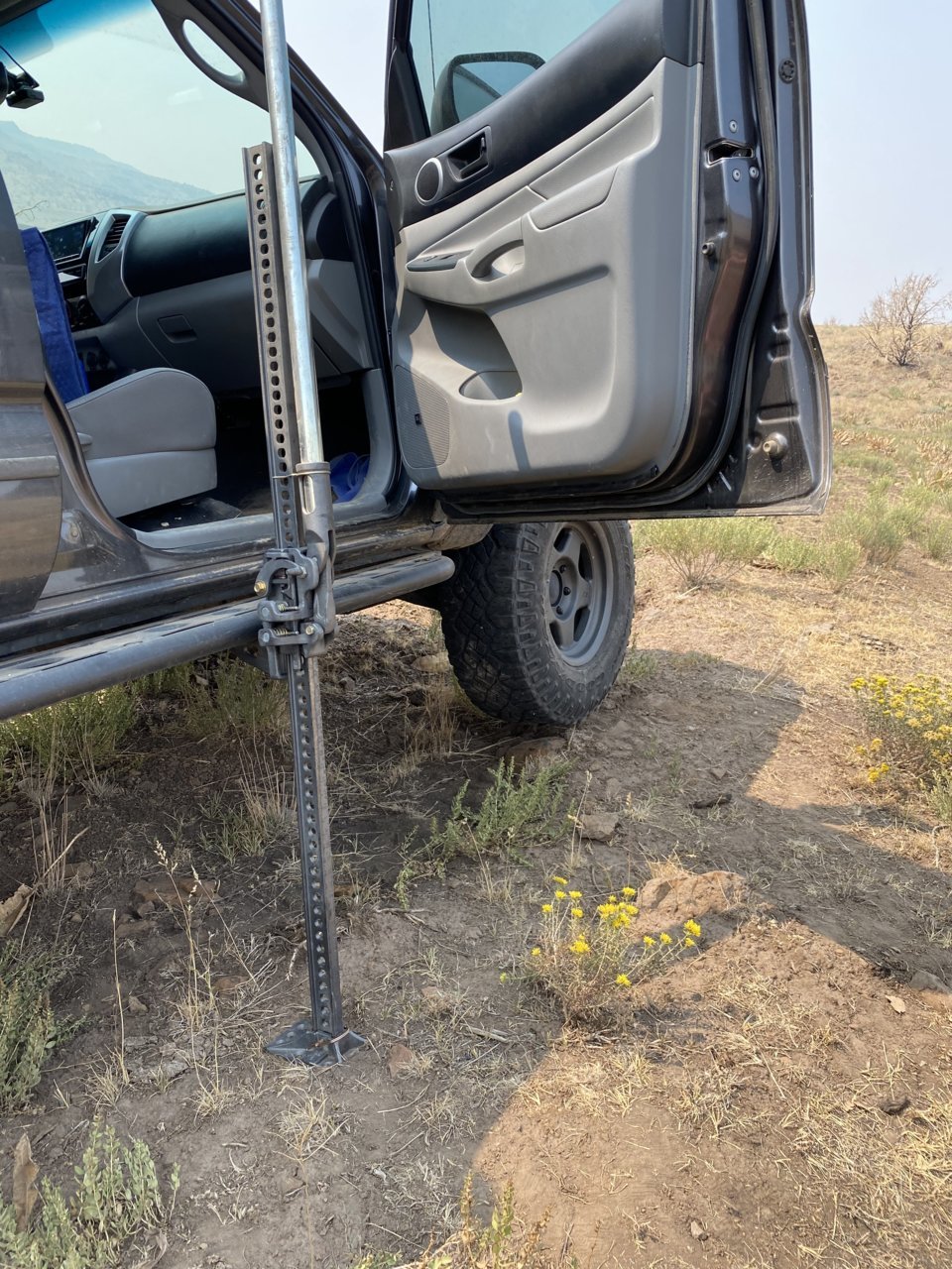

    If your vehicle has armor and you find yourself in technical situations then a hi lift can be invaluable. There are two specific situations I've been in where it would have been difficult without one. One, I had to lift the side of my truck off of the rock and slowly drive forward, driving off of the jack as I went. It worked great. The other was on uneven terrain and there wasn't an easy way to get another jack under the truck so we had to lift off of the front bumper.
    I now also carry a pro eagle jack and it's my primary choice of jack but I'll never leave the hi lift at home, it's too valuable a recovery tool.

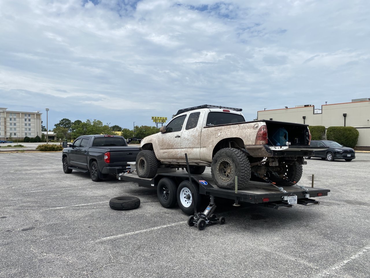

    The 2 ton one. While I have a 3 ton floor jack for garage use, the 2 ton is plenty for trail use. It’s even strong enough to lift my loaded trailer, which is a combined 8,000 lbs.
