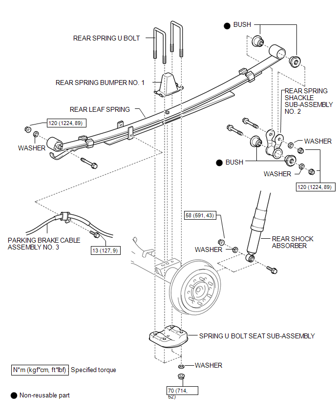

    3JOH22A
    3JOH22A トヨタ純正男娼
    Mar 27, 2019
    #288172
    12,430
    District 6ix
    3G Tacoma on 35"s, 5G 4Runner
    The Toyota factory service manual highlights non-reusable parts. The U-bolts have not been identified as non-reusable:
    bevo2000 and wayupnort like this.
