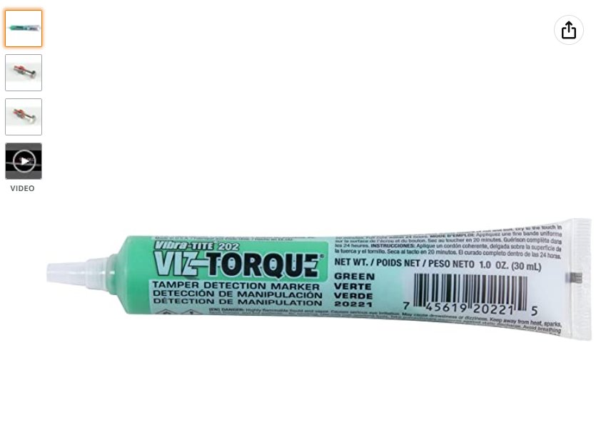

    ^^This! Same thing happened to me on the leaf pack bolt. Had the nut come completely off and the bolt was working it's way out. I must have missed re-torqueing it when I re-torqued after 100 miles. Was kind of a pain to get a new bolt and nut and replace.
    I've started using this to mark the nuts so you can visibly see if they have backed off:
    https://www.amazon.com/gp/product/B07Q3SQ53V?ie=UTF8
