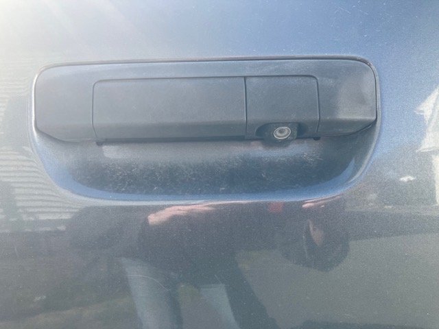

    Is it actually a factory camera, or was it an addition from a previous owner? I see lots of stuff in a Google search for aftermarket head units and tailgate camera kits, but not a lot pops up as a factory option.

    It is a factory camera, as far as I know. The Youtube video showing how to extract the cable/connector out of the headliner made mention that Toyota sold the base vehicle with the camera, but the rearview mirror with the integrated display was optional.
