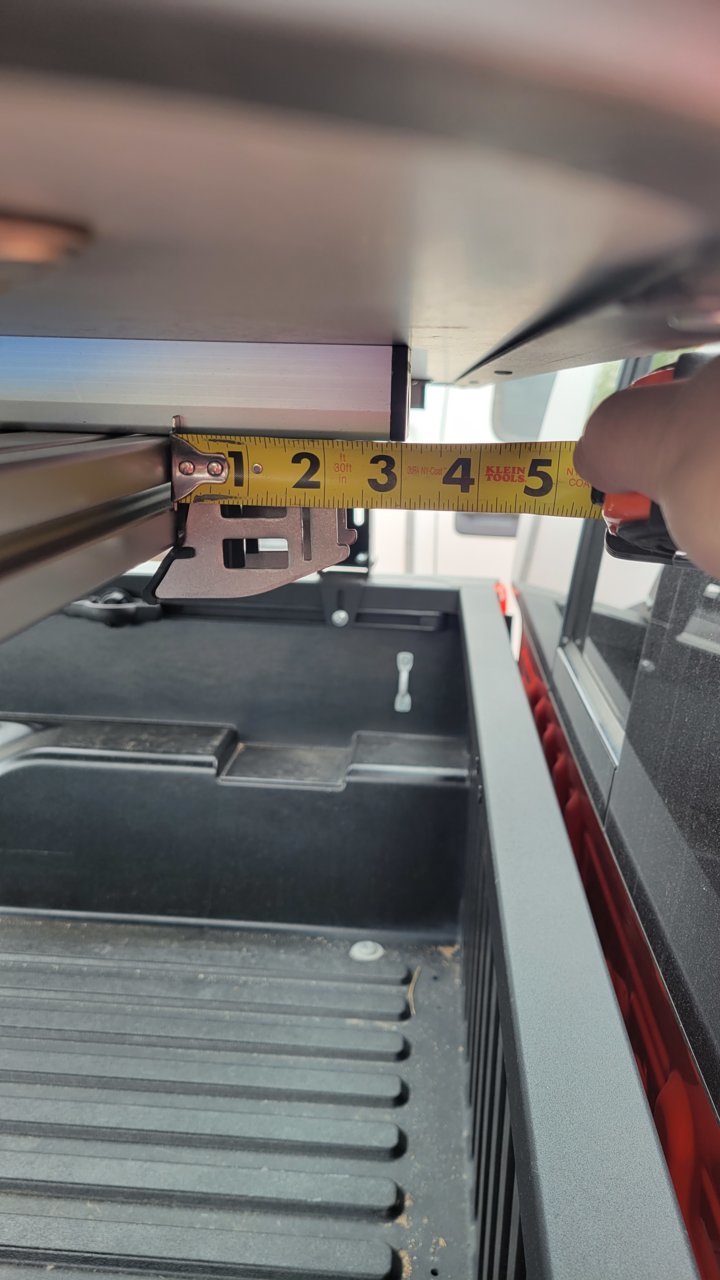

    @Redsquirrel Thanks for all this info. I was looking at getting the ikamper 3.0 mini as well. However, I want to know the maximum distance between the front and back cross bars. I've picked up the victory 4x4 overland bedrack and the distance between the front crossbar and back crossbar is roughly 52 inches. Is that distance too long for the length of the iKamper mini's rails to fit on? I appreciate your help.

    If I have time at work tomorrow I'll take a tape out and get measurements and pics of mine. I just mounted it up in the last month, and I think you'd be okay. I can't sweat to it, though.

    Awesome, I totally appreciate that! Mostly interested in the length of the rails on the 3.0 mini since they are slightly shorter than the tent base itself (from what i've seen).

    In a couple hours, if work isn't crazy I'll see if I can get out there. You are correct that they are a bit shorter than the base, and the clamps take a bit of space at each end as well, but I'd be surprised if they can't run on any bed rack that fits a double cab Taco.

    Ok, so today was nuts. My apologies for the delays.
    Here's the length of the rails for the iKamper Skycamp Mini 3.0 (just under 53 inches" and then a shot of the bracket shoved all the way to the end. With the end cap and the bracket you lose about 3 inches per end, so knock 6 inches off the full rail.
    For @Vettes 'n Tacos here is the height of my @CaliRaisedLed rack and how it sits. The front of the tent is just below or right at the roofline, and the rear of the tent sticks up a bit more. I've seen no MPG change in the time I've had it installed. One thing to note is you can't use the front window's awning rods with it mounted this low because the would hit the cab of the truck. This is why the drawstring window feature on the 3.0 was a must have for me.

    Okay, so since it wasn't listed on their website, I contacted iKamper support. Here are the official rail dimensions and maximum crossbar distances for anyone interested in the iKamper Skycamp Mini 3.0. The maximum distance outer edge to outer edge for the crossbars is 39". For my overland bedrack by Victory 4x4, I'm simply going to get 4 extra cross bars off sherpa. They are great and cheap and you can select your crossbar length. They are out of black in the 50" right now though, so I just went with the adonized silver since it'll be on my roof rack up top and not visible generally speaking anyways (especially with the RTT on there). Link is here. https://sherpaec.com/products/additional-crossbar

    Thank you so much for these pics and measurements! Looks like you could get away with 48" even though the official word is 39". I just installed the victory overland bedrack today to go over my softopper. I'll post some pics when I get some daylight. Now, waiting for a deal on a skycamp mini. I'm in Houston but can save $200 shipping if I buy from one of the dealers in San Antonio.

    48" would be too long between the two. On either end you've got at least 3 inches for the clamps. With the curve of the clamps I'd expect to lose a little more than that 6 inches to be able to drop straight down. 39" might be conservative, but I don't think it'd be much more than 40".
