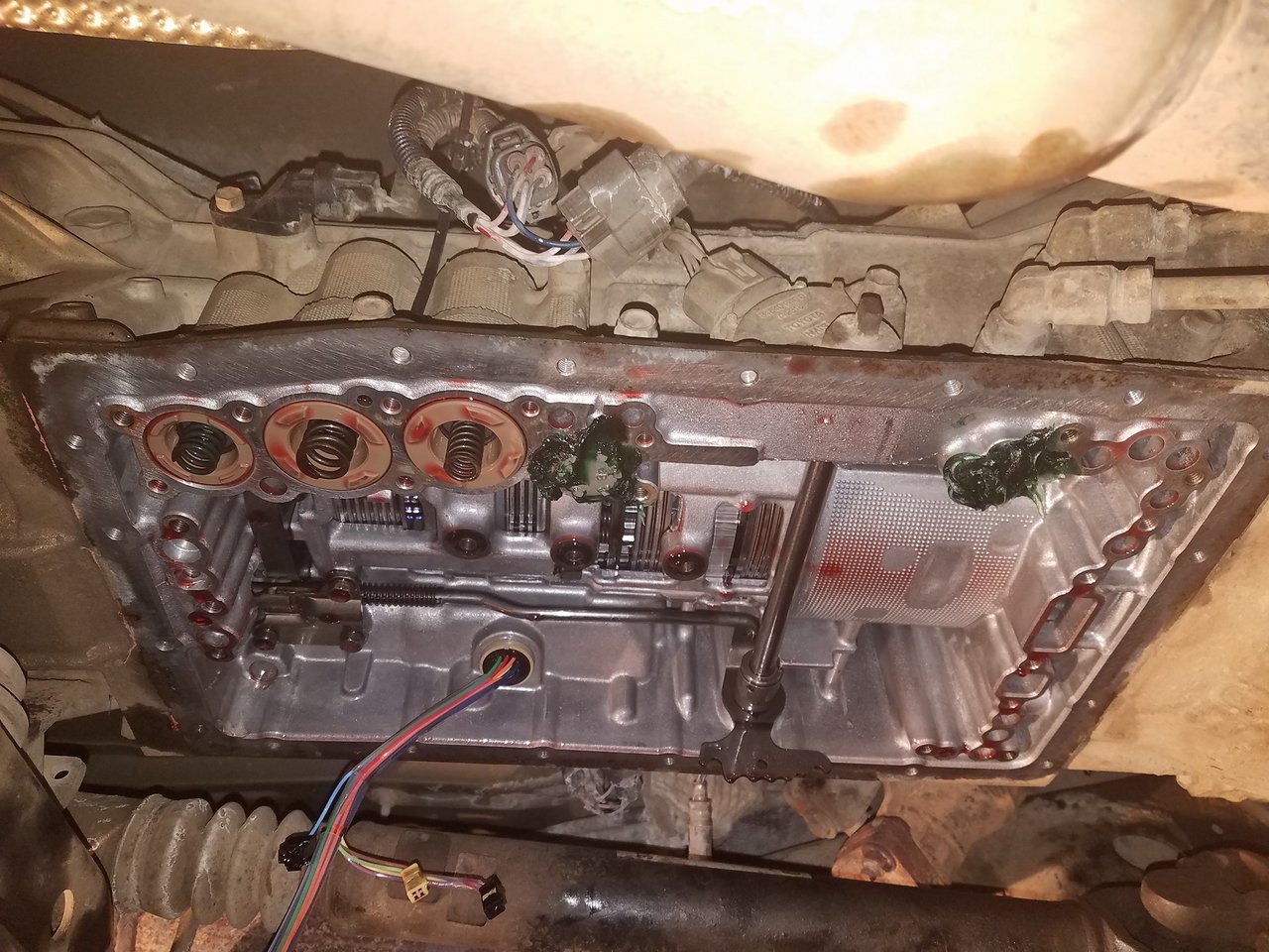

    Start by draining the transmission pan as much as you can, then remove the bolts holding it in place. (approx 20 bolts)
    Remove the Transmission filter (4 bolts) don't loose the rubber O ring on the back side of it.

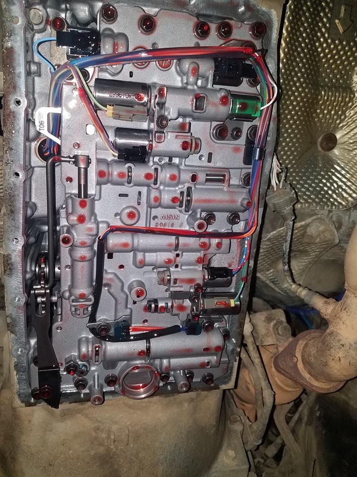

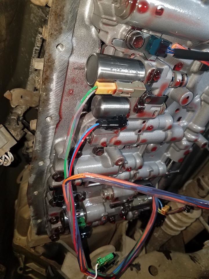

    With the pan and filter pulled off, you have now exposed all bolts on the valve body. The manual lever (bottom left in pic) needs to be removed when you drop the valve body. It simply slides into a hole but it can't be removed until you start to drop the valve body.
    Disconnect all the solenoids and pull out all the 10 mm bolts. A few are different lengths (about 4 up near the front of the truck IIRC). Make a note of them and where they came from.

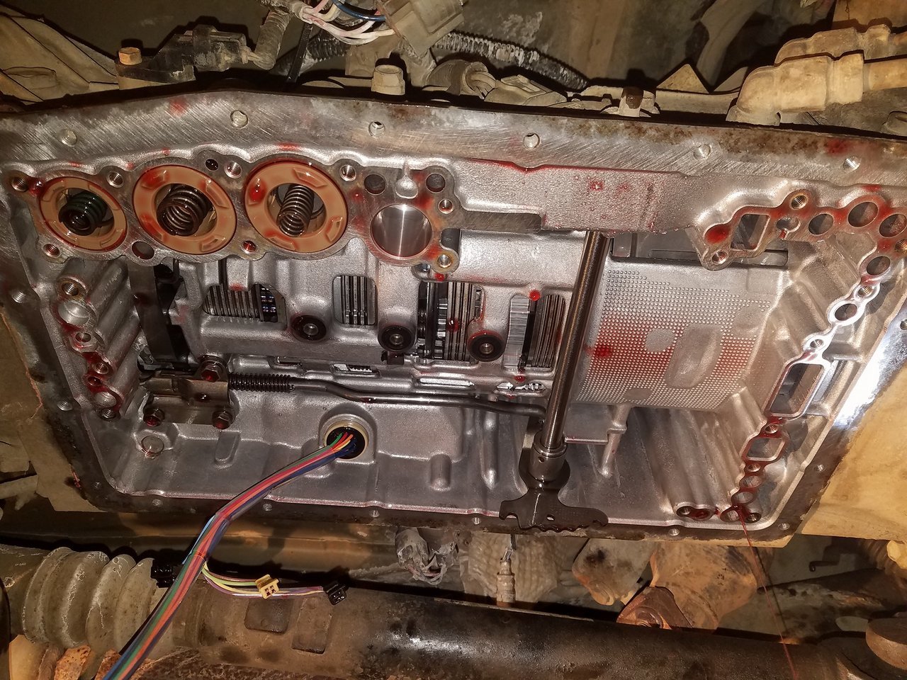

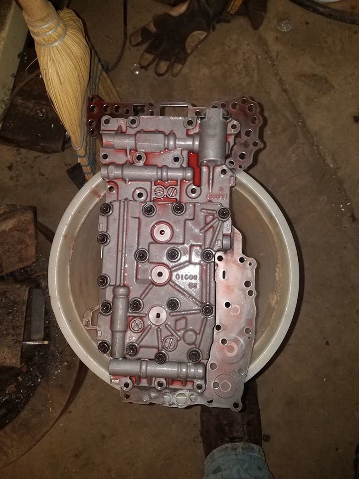

    Two parts fell out when dropping the valve body. One in the square hole (top right) one in the circular hole (top middle) more might fall out when you drop yours. Just take note of how they go together and set them aside for now.

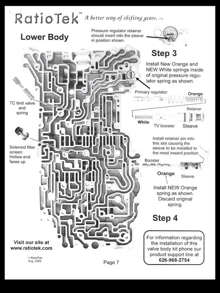

    This is step one. Easy to do, take apart, add spring, reassemble. The picture sucks I know, the top of the picture is at the bottom. The b1 accumulator is at the top right of this photo.

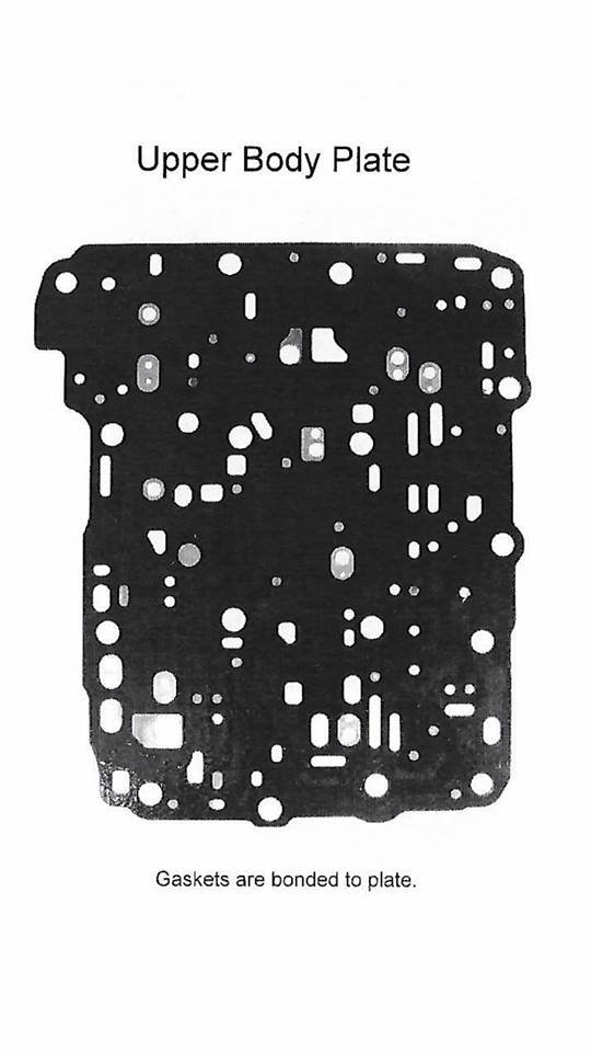

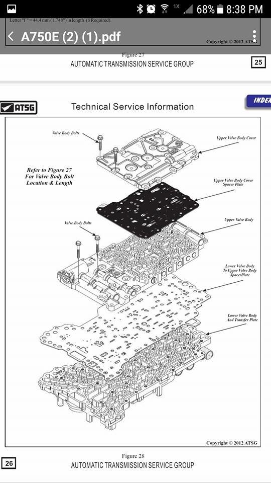

    The black upper plate and white lower plate in this picture. Note them for now. When breaking apart the valve body, you won't have to worry about moving check balls around if you pull these apart correctly. The check balls are in two locations. location 1 is in between the very top plate in the this pic and the black plate cover. location 2 is in between the middle plate and the white plate underneath it. Be VERY careful when separating these as check ball locations can vary from year to year and you don't want them to fall out.

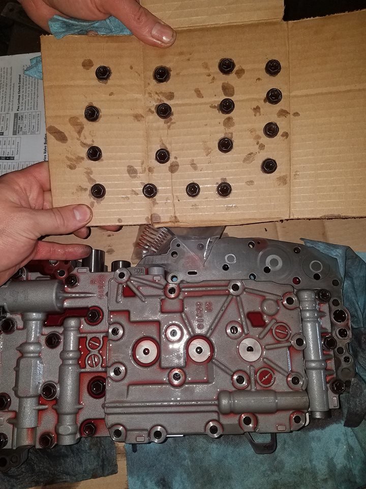

    I used cardboard when pulling screws. Something I learned when helping friends do headstuds and EGR delete on big diesels. Lengths very and this way the bolts will go back in the same holes without question. Unscrew these screws and pull the top plate gasket (black plate in previous pic) WITH the upper body so that checkballs can't fall out or move, now flip it over to the side so that the top plate is upside down and you can now pull the plate to drill the holes.

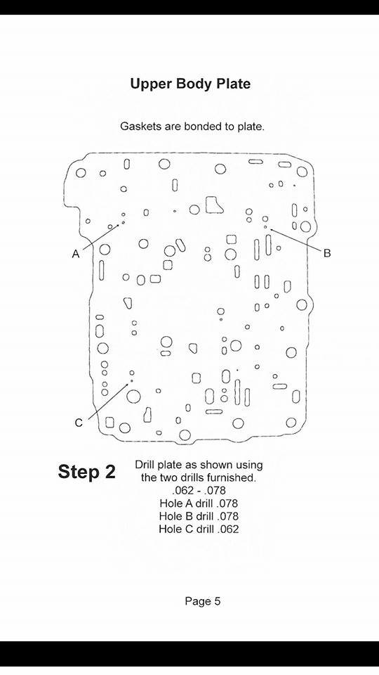

    The kit comes with the necessary drill bits. This is from the directions that come with the kit. It looks intimidating I know but you're not drilling new holes, you're simply making 3 holes that are already there bigger.

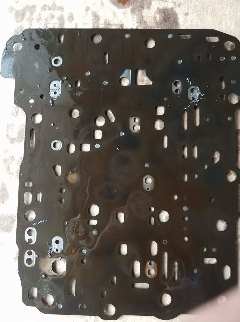

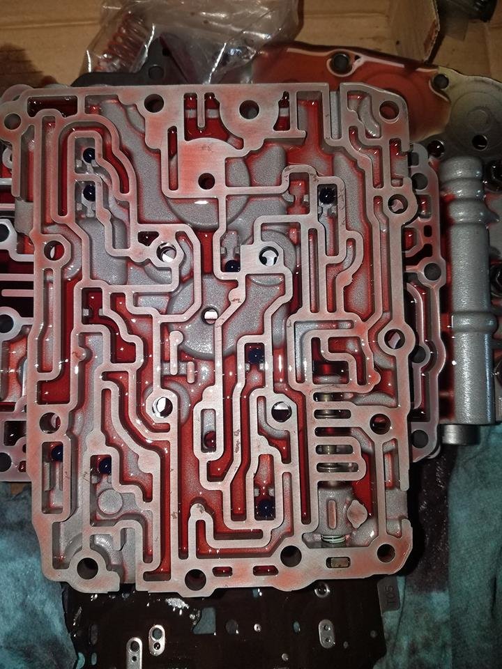

    This is what the top plate that you need to drill out looks like. Shavings show what holes are drilled.
    Picture of the check ball locations on my 2009 Tacoma. Yours might be different depending on the year. Take a picture of this yourself. You don't want to put a ball in a wrong location!
    My cardboard template of the rest of the screws on the valve body. Again lengths very so make yourself a template to avoid any possible mix up.

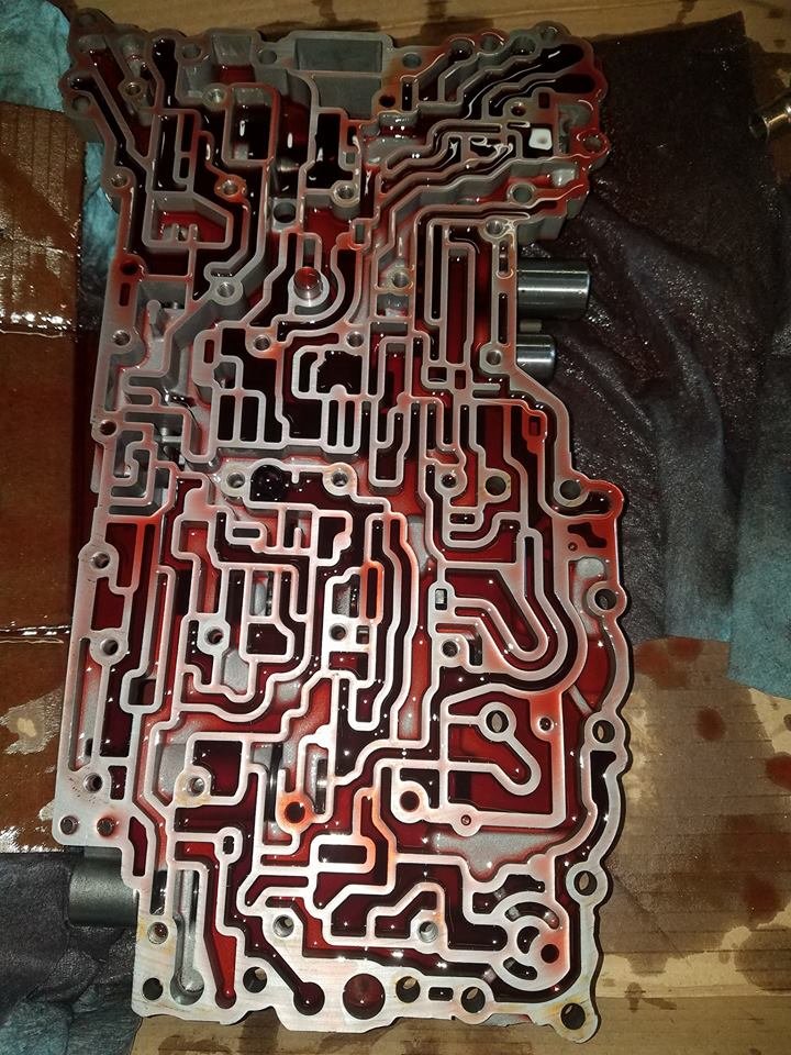

    Now the white lower plate from the diagram above.. Pull it WITH this piece so that check balls can't move. Set this together off to the side. No need to flip it or anything, just make sure the metal separating cover doesn't move or come off of the middle piece. The bolts still in the valve body top plate are all undone here but are in place to prevent parts from shifting accidentally.
    This is what you're left to work with now. No check balls to screw up. But you will be removing parts to add springs to two solenoids on the right side of the valve body in this pic.

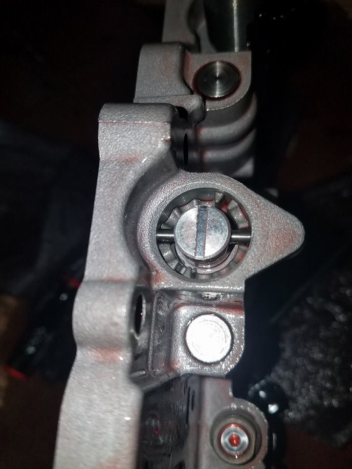

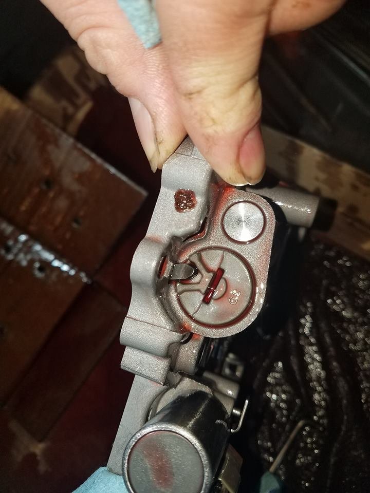

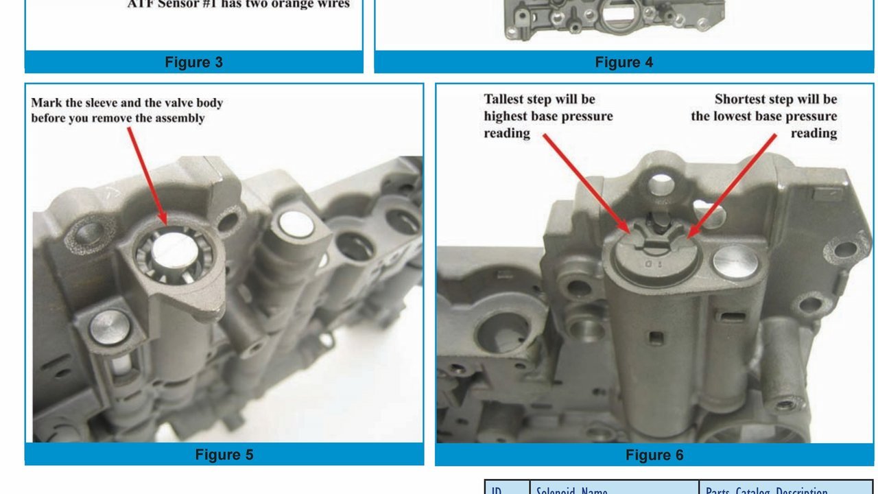

    Note the step that yours is on (take a picture). It has to go back together on the same step shown here (the middle step).
    Note this step too. Has to go back in so that it sits as deep in the valve body as possible. One slot deeper than shown in this photo per the install directions
    Just more info I found and another picture to help.
    Install the springs as shown in this pic. The parts are a tight fit but keep working it and it will go back together. The springs that come in the kit have a touch of paint on them so you cant accidently put them in the wrong locations. You shouldn't have to force anything. After you've installed the parts, you're done except reassembly. Congratulations!

    Middle step on the piston (whatever you want to call it) is what the shift kit manual wants you to set it at. Revise your original post because the way you pulled it out is not the way it goes back in.
    On the sleeve, it has to be positioned in such a fashion where it gets set to it's deepest setting when installed back into the valve body. Your picture is very helpful, but for guys who are less visual and more clerical, this is for them.
