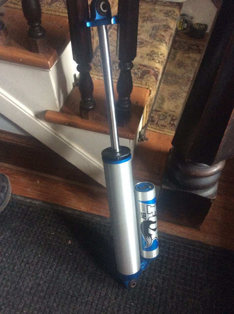

    I've been slowly working on this swap. It likely has the potential to embarrass some fairly expensive and involved set ups for a fraction of the price. If you decide you want to try some 18-19 3.0 blue Shocks, drop me a note, I have a couple of pallets full.

    I never BS unless I'm messing around. 27 sets of rear, not sure on the front. Pics asap. They are new take offs from the Roush Raptor builds.
    The rear swap won't be different from any other 12" swap, except for the large chunk of money one won't have to spend on rear shocks.
    The front swap will potentially require reworking the the shock... much more involved.

    The 2nd gen 18 - 19 Shocks contain a lot more ability than one might expect. They have a 3.0" body/2.5" piston, multiple bypass zones, and base valves (nice upgrade right there alone). They also have extra seals in certain locations, and protection for the shock shaft. They can be rebuilt and revalved just like any other Fox. The rear units are roughly 31" extended, and 19" collapsed, which of course gives a clean 12" stroke in a relatively compact package.

    Live valve is a more advanced version of Ohlins older CES system. Yamaha had the CES system on the Apex Snowmobile when it debuted in 2006. It had the same setup, a solenoid mounted to the compression adjuster, but it was simply to adjust it via a button... it wasn't always adjusting for conditions... essentially it is what Fox iQS is. After the wire to solenoid broke enough times, we found that Ohlins offered a manual conversion for it. Agree though, most folks, the work required would be too much.

    Those the aftermarkets or the OE take offs?
    Johnny DemonT likes this.
  18. Feb 4, 2020 at 12:07 PM
    #18
    Jowett
    Jowett Well-Known Member
    May 5, 2016
    #186182
    1,625
    Brian
    North Adams, MA
    OEM take off shocks in aftermarket boxes. Roush pulled the brand new stockers and installed the Fox Shox pictured in photos one and two in the first post.
