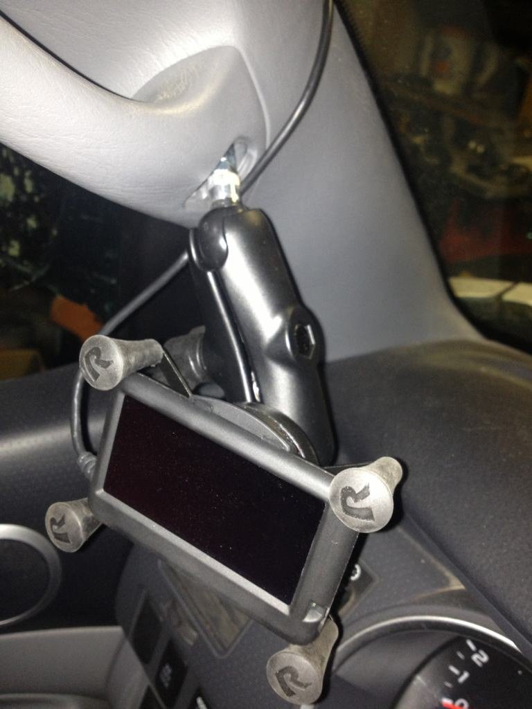

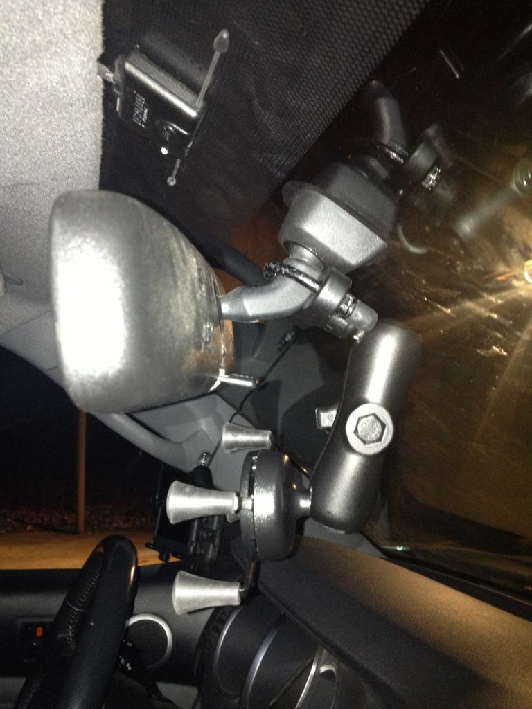

    I use these mounts for my Ultragauge and my iPhone
    I got my original idea for the "oh shit" bar RAM mount from this thread http://www.tacomaworld.com/forum/2nd-gen-tacomas/93807-ram-gps-mount.html and I just looked to improve on it. I think I saw some "handlebar clamp mounts" for the rearview mirror which helped me along in the process of thinking up my rearview mirror mount. RAM does produce a manufactured unit that is stated to be a drop in replacement mount for our stock rear mirror but my research led me to believe it would not work for my truck.

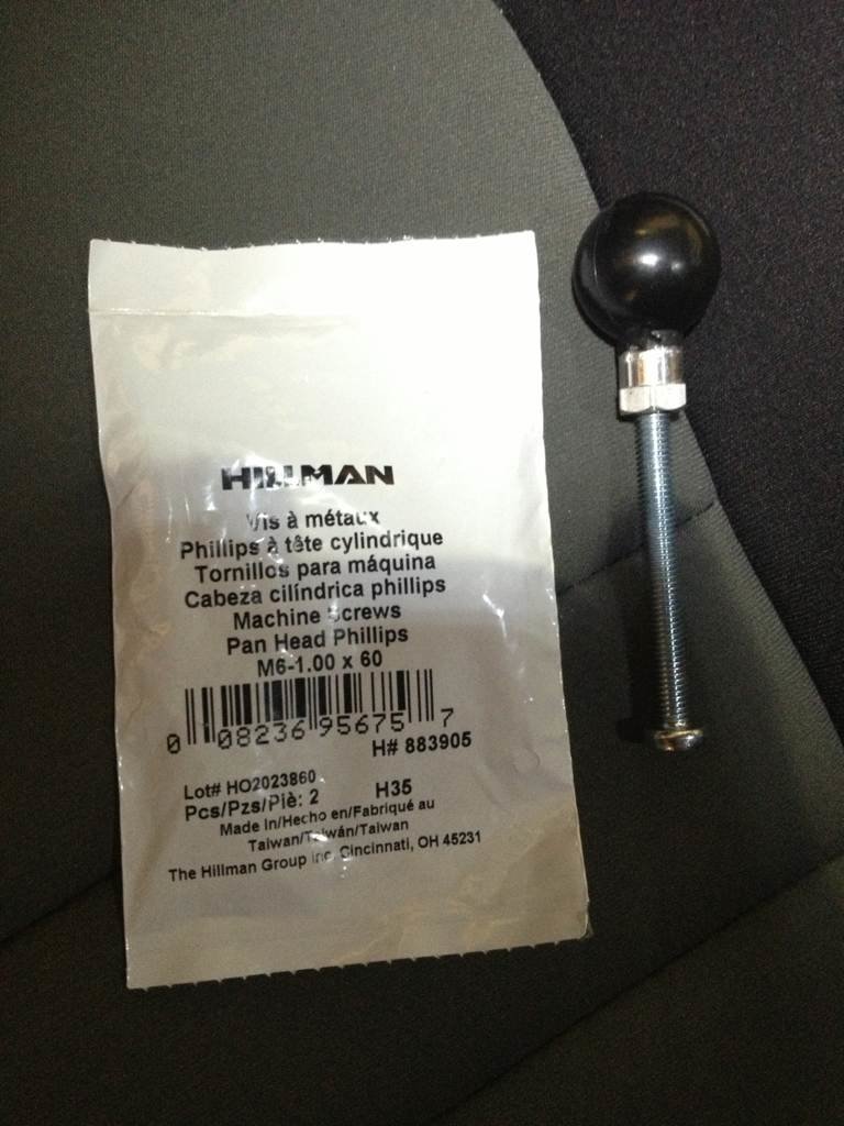

    For the "Oh Shit" bar mount the parts are as follows:
    RAM Mount RAM Double Socket Arm f/1" Ball RAM-B-201U
    RAM Mount M6 Threaded Female Hole w/1" Ball RAM-B-273-M6U
    RAM Mount Universal X-Grip Cell Phone Holder with 1-Inch Ball RAM-HOL-UN7BU
    M6-1.00x60 Phillips Screw (Or similar/found mine at Lowes)
    A couple M6-1.00 nuts (acts as spacer)
    M6 washer

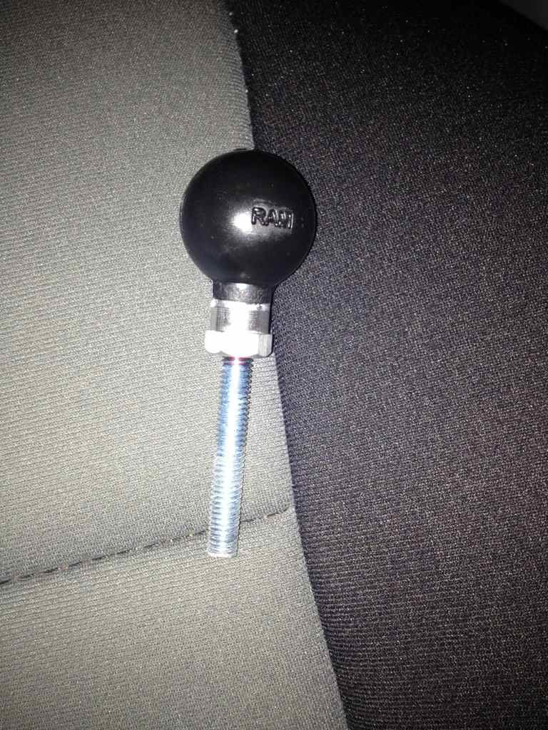

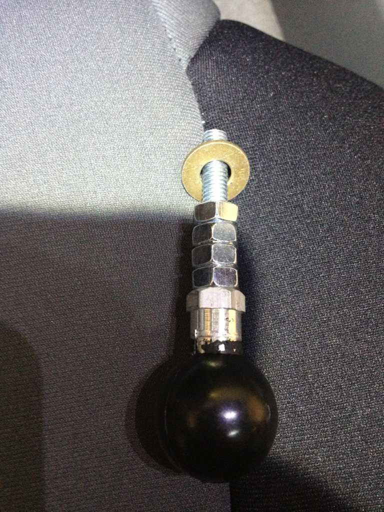

    Instructions:
    1.I used red loctite to ensure the bolt stayed screwed within the one inch ball. I cut off the pan head with a dremel once tight.
    2.Screwing nuts onto the bolt act as a spacer to give the RAM bolt mount enough length and the washer ensures a good seating surface
    3.The screw should screw directly into the "oh shit" bar mount factory threaded hole (mine did)
    4.The rest should be self-explanatory
    For the rearview mirror mount the parts list is as follows:
    Ram Base with U-Bolt RAM-B-231U
    Instructions:
    1.Tube clamp should have a plastic spacer included. I didn't use it.
    2.Tighten around mirror.
    3. The rest should be self-explanatory
