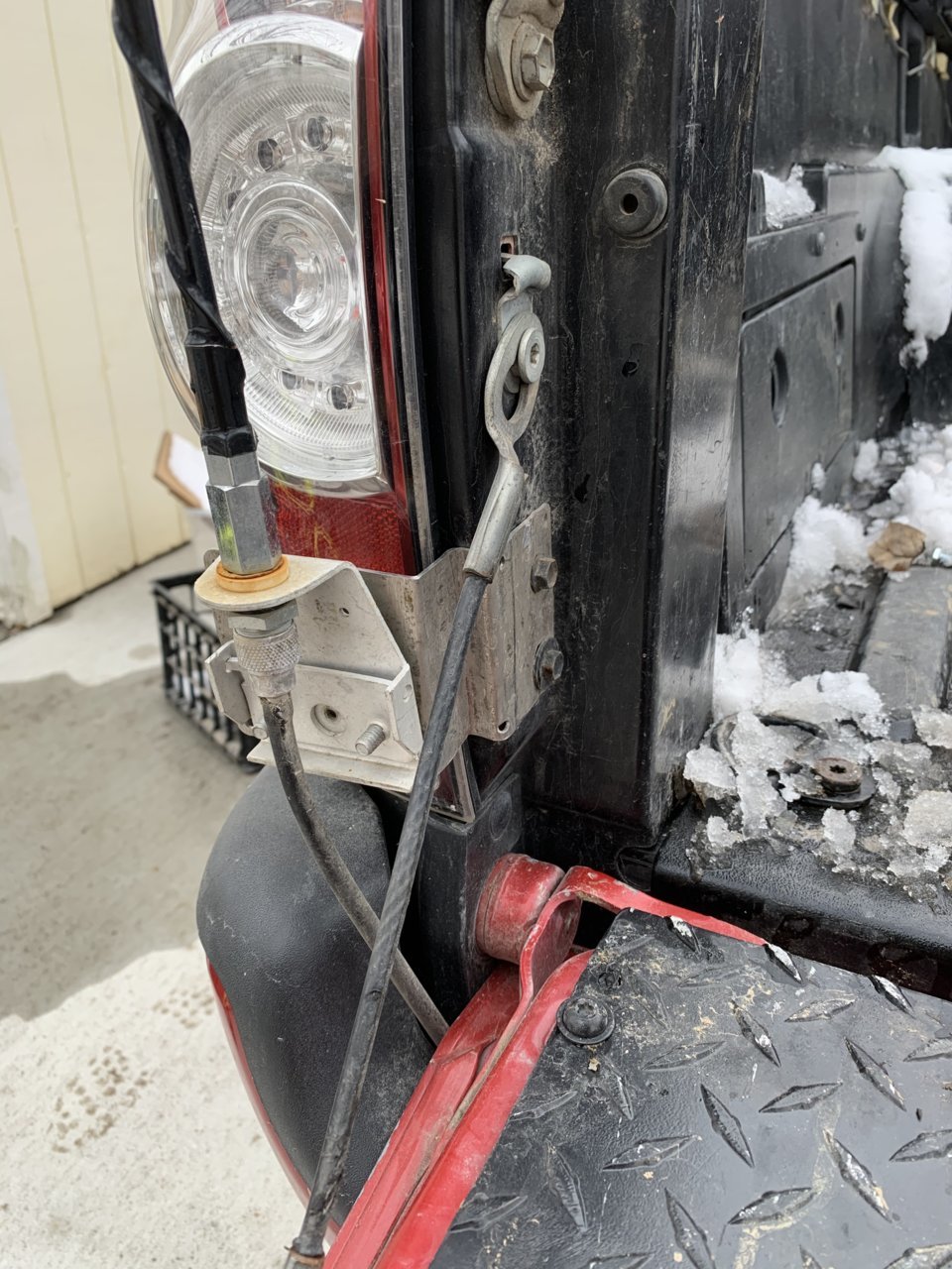

    I installed mine a month ago following the main harness under the cab n bed to back of truck. Once I take some photos I’ll share em.
    The wire come ups under drivers seat to under hard plastic under drivers door. Follows the frame up under dash to one of the knock outs for a switch.
  5. Jan 15, 2021 at 11:07 AM

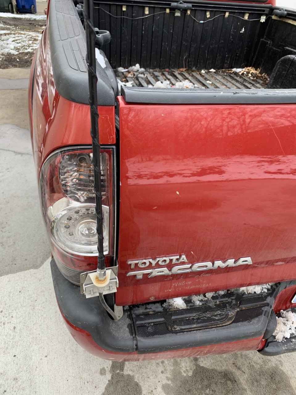

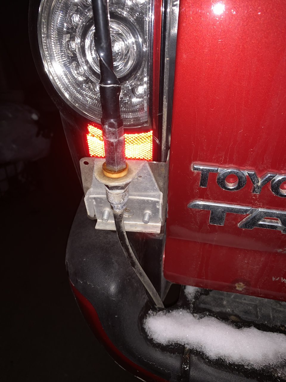

    I’ll get more in the morning. Here is a rough idea of the mount
