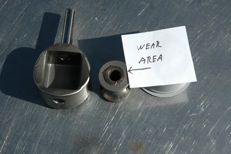

    The original racks, up to around 2001 had a poorly designed "rack guide" known as the "roller style". I recommend a thorough inspection first before purchasing parts or planning to do much work on these units. Many of them were used for quite a time with the bad guide, causing other terminal damage. I think this collateral damage is why there is such a bad rep on rebuilds as the majority of the racks produced and rebuilt were the roller style. A rack that passed a rebuilders pressure test may not last with use. The racks with the newer guide seem to last significantly longer and as such make a much better candidate for service.
    Don't be deterred if you have an early rack with the roller guide. Even if the rack shaft has been damaged by a roller guide (see below, "divots"), as long as there is no other damage to the shaft in the form of deep scoring or rust pitting, the successful upgrade to the new guide is completely realistic.
    The guide combined with the pinion gear is all that stabilizes the driver side of the rack shaft. They would get loose in as little as 15-20K miles. This short life was exaggerated by lifts, large tires and hard use. The increased angle of tie rods to rack due to lifts is IMO the single worst offender. Stock geometry allows for more of a straight line for the push pull steering action. The higher the lift, the greater the angle, the faster the wear. The new guide is interchangeable with the old and is a worthy upgrade, assuming no other serious damage was caused. All rebuilds listed as "95-01" should be assumed to be the old type. All the 1st gen 4wd racks are the same aside from the guide.
    Changing out guide only
    http://www.yotatech.com/f2/how-replace-steering-rack-guide-pictures-215931/

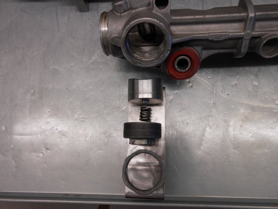

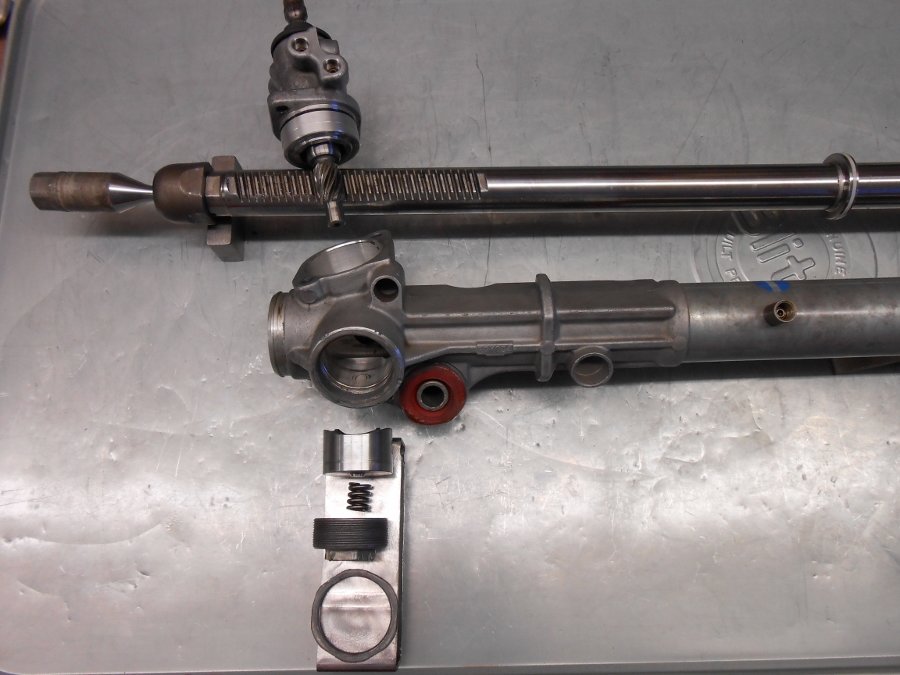

    Rack with new style guide. Preload adjuster cap has Allen type socket.
    Rack with old style guide. Adjuster has an external hex head. Happens to be on a rebuilt rack.:(

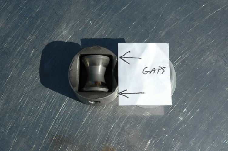

    Below is the roller style guide compared to the newer style and lastly the area that wears in the blink of an eye. You can see the PTFE (or something like it) mushed away from the thrust surface of the roller. Years ago I would shim up the play in the roller style with circular "washer" shaped shims from McMaster Carr. It worked pretty good but the new style guide is better.
    Take it apart before ordering any parts. Internal damage can't be detected till it's apart. You can always put it back together and use/sell it as a core. One the subject of cores, should you go with a rebuild, for whatever reason, I would avoid any that come with the old style roller. The old style will have an external hex head on the preload adjuster located below the control valve (looks like a giant drain plug). The new style looks like a big Allen socket.

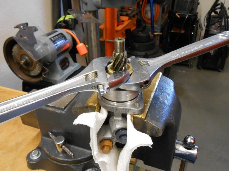

    The fun begins, control valve tools
    With the rack on the bench keep in mind that no matter how well you think the unit is drained it will spit at you when you cycle things back and forth, the voice of experience here.
    I like to index the control valve shaft/pinion gear teeth to the rack teeth. They have already gotten to know each other so why break the relationship. Extend the driver side rack shaft (RS) out till it stops (boots off). Mark the control valve shaft (CVS) and control valve body (CVB) so they can be reassembled in the same relationship.
    The divot seen below on the RS is where a worn/loose roller guide was rubbing the rack in the "steering straight" position. Close inspection actually reveals 2 side by side divots, before and after a lift/alignment/poly bushing install.
    Remove the CVB and the hard lines. The union seats will fall out and the driver side is different than the pass. The only really special tool for the CV is an octagonal hollow socket of sorts, the "octOsocket". This one was made from brass round stock I had laying around. It is 1.27" from flat to flat with a 1" hole. Below are a few of the steps I took, layout, cutting etc.

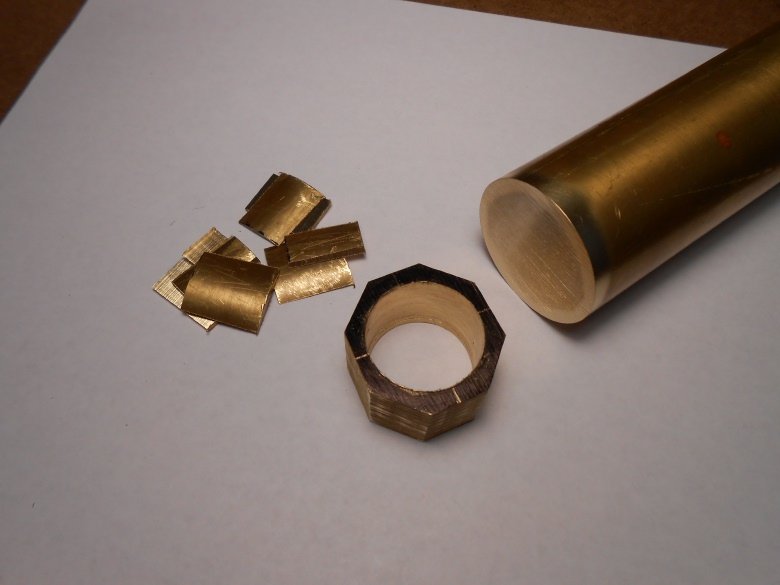

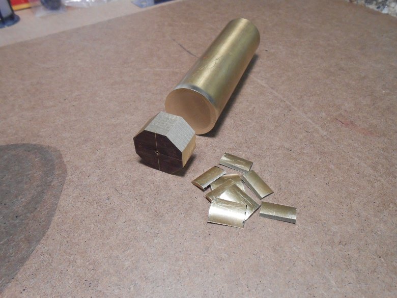

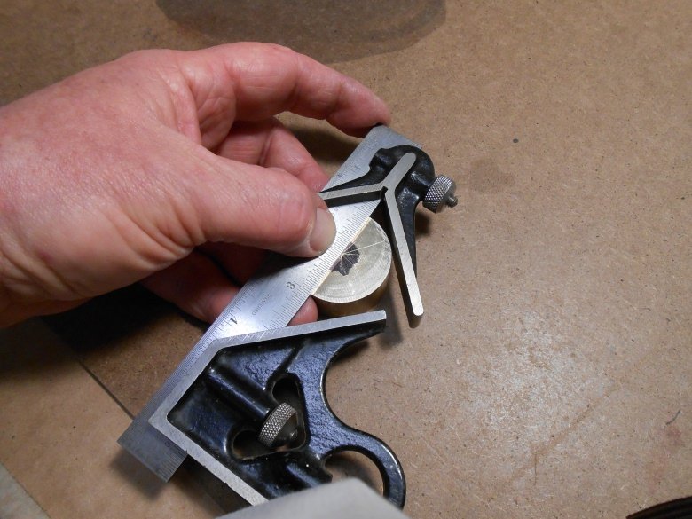

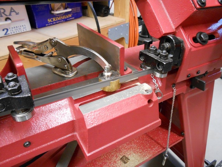

    An easier method would be to grind/cut flats on a 1" shaft collar (the hole is already there).

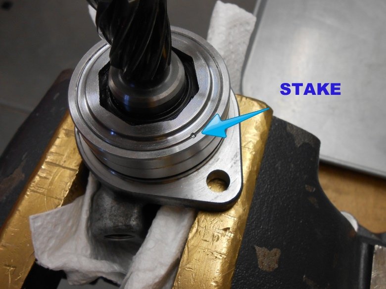

    Shots of the lower seal carrier and using the octOsocket. When installing the carrier tighten it to the "stake", it just needs to be snug, don't worry about the torque spec. Then re-stake lightly at another spot.

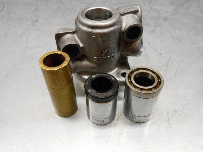

    The three improvised drivers for r+r of the 2 CV seals and the upper bearing. A piece of 1" ODx1/8" wall brass pipe and 2 sockets. Anything that fits can be used. The pipe presses out the top seal and bearing while the sockets do the install of the seal then the bearing.

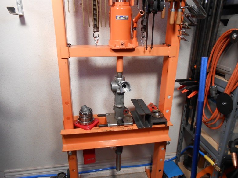

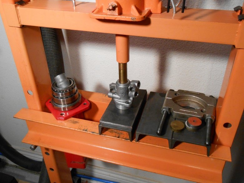

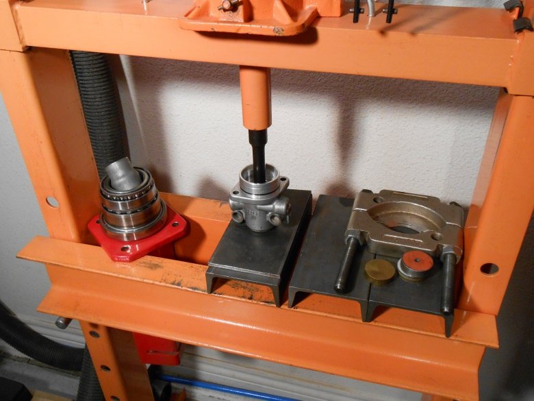

    Pressing out the top seal/bearing. A note on pressing. All the press work on the entire rack could be done with a hammer but the chances of damage will increase dramatically. In either case be careful, these are small delicate parts. Hammer blows could easily damage the top bearing during removal and I have not been able to find that bearing separately. It is a KOYO DG1935A. (Correction, Toyota does sell the bearing.) Good luck

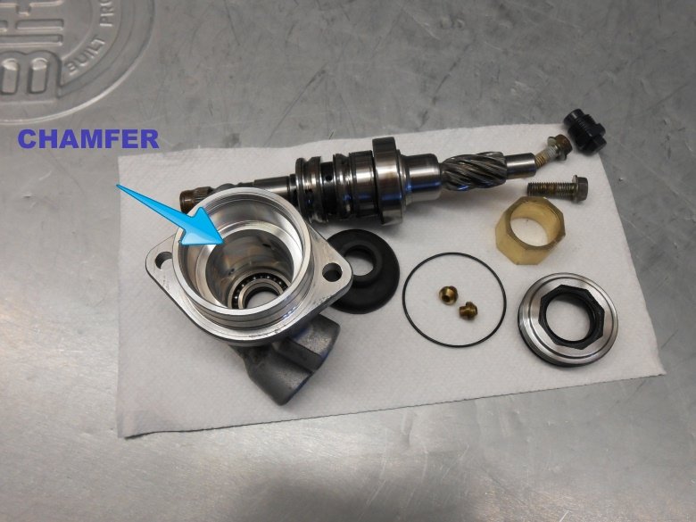

    Semi exploded view. The chamfer helps settle the 4 Teflon rings during assembly.
    Installing the seal and bearing. Same operation with 2 different sockets and an extension.

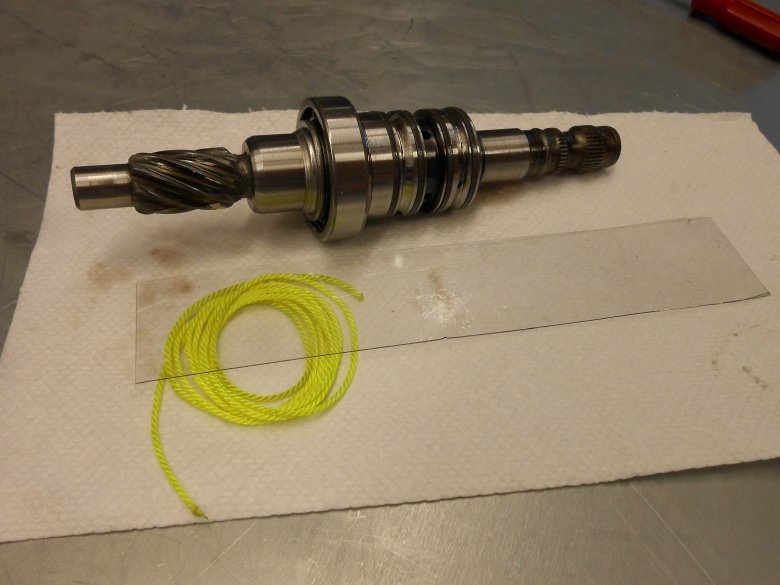

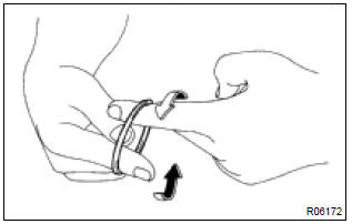

    The 4 Teflon rings on the CVS get stretched when they are put on and must be squeezed back to shape with this improvised "ring compressor". It is just thin plastic from blister packaging with the burrs wet sanded off. Try to save a few of the old rings to practice the stretch with.
    New Teflon ring "stretching" procedure.
    Ring compressor in operation.
    When it's time to install the re-ringed CVS into the CVB, first feel the ports inside the CVB with your finger, OUCH! To avoid cutting the rings, slightly twist the CVS CW when looking into the bottom. This way the rings are rotating off the razor sharp edge of the ports instead of into them.

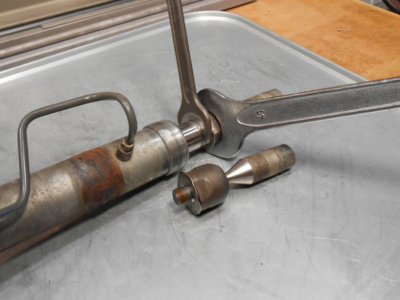

    ITR removal, typical, 41 and 30mm or what ever you got.

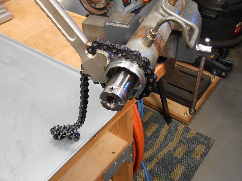

    Remove the "end stopper" (Toyota's word not mine) with a giant wrench or a big chain wrench/pipe wrench. Note the hole in the flat at the end of the shaft. It connects to a hole on the other end to allow air pressure within the boots to equalize as they expand and contract. Don't let it get plugged with excess grease.

    The setup to press out the driver side seal/spacer (toward the pass side) with a socket and a piece of fence pipe. I was able to just push this seal out by hand after getting it started with a few taps from a rubber mallet. The tape is to guard against scratching the inside of the rack body. I used an 1-1/16" socket. It should be just under 1.43" OD.

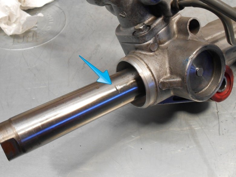

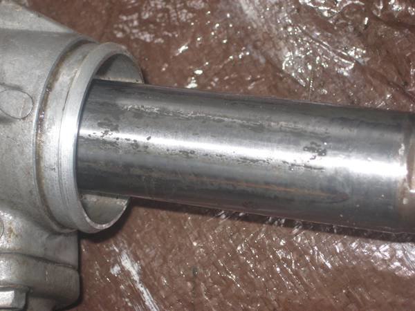

    Take a good look at the rack shaft and look for the "swept" area where the seals ride. It's only the last 14" or so of the pass side. Total rack travel is only around 7-1/2". At this point it should be obvious where any pitting or shaft damage would cause trauma to the seals or the Teflon ring. Try to polish any nicks or scratches. With a good light inspect the inside of the rack body for damage. I found a worn area dead center where the divider piston resides when driving straight. This was due to the loose roller guide allowing the shaft to flop up and down. It was pretty smooth and the previous steering effort was smooth so I let it go.

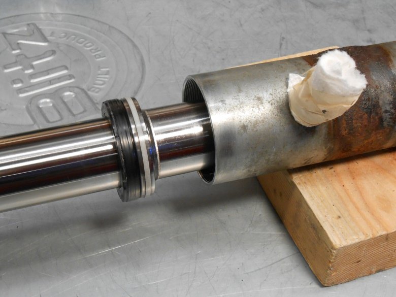

    Stand the rack shaft on the bench with the pass side up. Slide the seal and spacer up against the divider then Lower the rack body over it. Tap the body down with a rubber mallet till the seal seats. Be aware that the end of the rack shaft must align with the reduced diameter hole in the rack body towards the driver side, keep it straight.

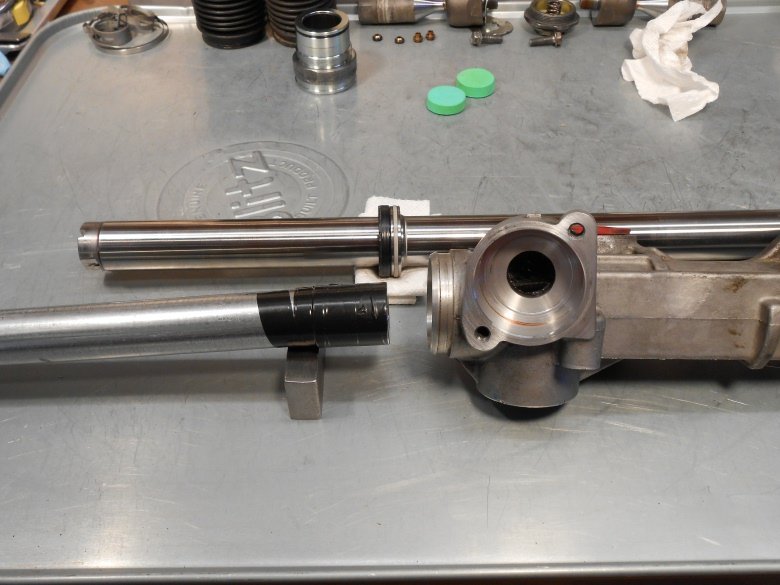

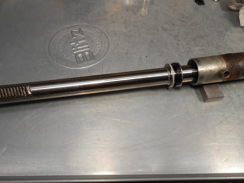

    Next comes installing the rack shaft. First install the new Teflon ring and o-ring with the same technique as the control valve rings.

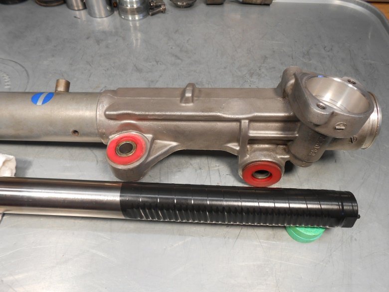

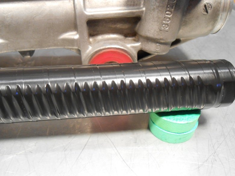

    The SST for the final shaft install is tape. After double checking and removing any burrs (on the teeth) clean the rack tooth zone with solvent. Then wind tape nice and evenly around the gear end of the shaft. Start right at the inside end of the teeth (no further in) and wind towards the end. The (wet with ATF) seal will be sliding over this tape and "off" the sharp edge of the tape. Do not push the shaft into the body any more than flush with the pass end as the driver side of the divider piston has a ridge (weld?) that will damage the seal. Familiarize yourself with what is going on with that first. The shaft will not be removed after this and the tape can be unwound off the rack teeth from the driver side. ATF will cause the tape to leave black adhesive on the shaft but it can wiped off.
    Nicely taped teeth.

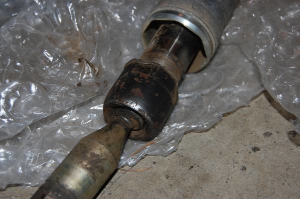

    NEW PICS Rust, the rack's biggest enemy.
    Rust and scoring on driver side. Could be cleaned up and used with new type guide.
    Most likely terminal rust on driver side. Impossible to tell because the area swept by the end seal can not be seen without removing the rack shaft.
    On the passenger side the seal sweeps nearly all the way out to the ITR so rust here is nearly always fatal.
