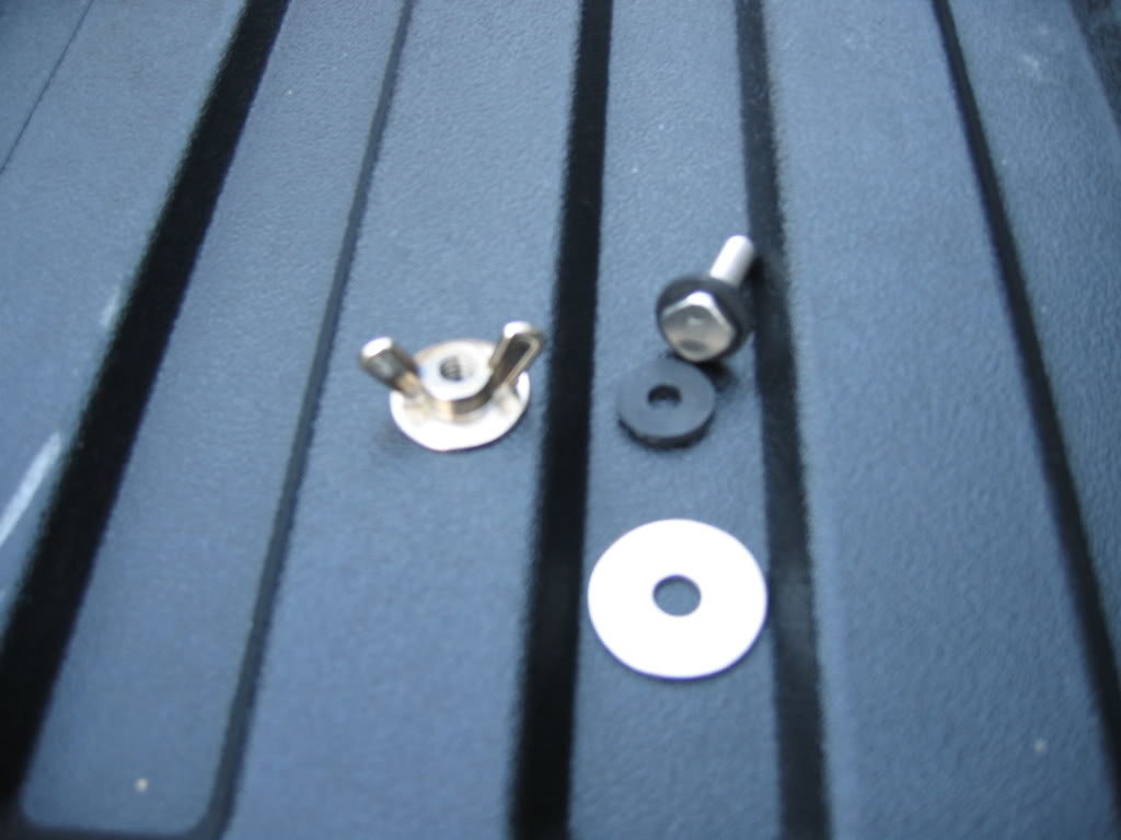

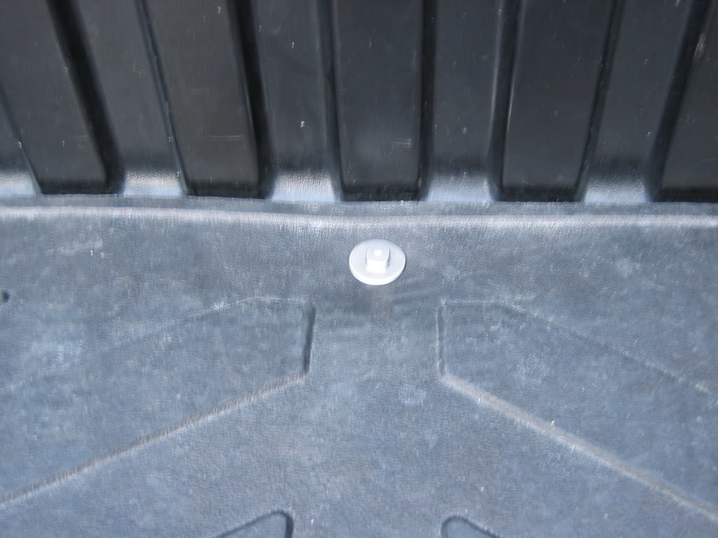

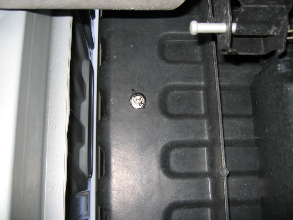

    I am not sure if this has been covered before but here is a quick and easy bed mat mod. I was worried about someone possibly stealing my bed mat or it possibly flying out so I drilled a hole in the front of the mat where the factory center drain hole is. I then used stainless steel hardware to bolt it down. Sorry in advance for the poor pics.
    What you need:
    Wingnut under truck:

    Ta Da, all done:

    Thanks for sharing this good idea. I think I would use a nylock nut down below, as they don't require pressure to stay in place.

    That might be a good idea too. I used the wingnut with a rubber washer. The rubber washer adds friction, reduces vibration, and keeps the wingnut in place. It can also be easily removed if you want to take the bed mat out.
