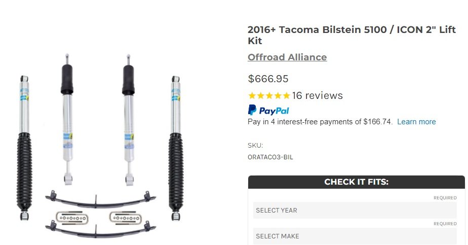

    I'm hoping to rest assured that by installing my newly bought kit which is here below. Its a common kit I know but I hear from different people that lifting will be fine with no drive line vibration and others say you will have vibration and I will need a carrier bearing drop kit to take care of this. The setup I'm looking to run is front struts set at notch 3 which is rated at 1.1" re-using my stock springs. Rear looking to remove overload spring and install icons AAL 1.5". So this is nothing insane as lifts go so I'm wondering if anyone else is running this and what have your experiences been with ride quality and with any driveline issues or issues in general caused by lift? I also ordered the front diff drop kit but again I've been told I really wont need that since this is a mild lift. Please any thoughts or advice would help.
    2019 TRD Off Road, Tires are 265/70/R17 with Venomrex vr602's -12/ 17x9 wheels.

    You’re good bro, wont need any of that stuff
    put it this way thats less than a factory lift

    I didn’t get any driveline vibrations. 5100 AAL with ome 885 springs set on 0. No diff drop either.

    Sub'd too. I recently did 5100s on front+rear, stock springs and AAL. I put the front on the second notch from the bottom, as I have a front bumper + winch + twin compressor hanging out in the front. This kept me level on the flat and I've got zero vibrations.

    Same exact set up below. 5100's all around, stock coils 1.1" lift + Icon 3 leaf aal. No UCA upgrade, no vibes, etc. Zero issue...I have 30k miles on it with this set up. 265/75/16 tires. Truck rides so much better than the stock SR5 shocks, but may not be a huge diff from your OR, but worth the upgrade I think. You will be fine. Not sure on the front diff drop as I'm only a 2x. Good luck. https://www.youtube.com/c/TravelingbyTacoma

    2" in front with my 5100's, on stock coils. No issue whatsoever.

    My advice... cancel the carrier shim order. I had the same worries before my suspension upgrade (2" lift) and ordered the shim... come to find out i had no vibs and never needed it. As far as the differential drop kit you wont need it for that amount of lift.... better off without it.

    Awesome , this does make me feel better about just going all in. I honestly never wanted the aal the kit just came with it. Soooo I suppose a little lift out back wont hurt. THanks again.

    You'll love how bigger and better the 5100s are compared to the stock O.R. Bilsteins.
    Mine's set @ 2" in front with a 1" block in the rear and the Taco sits perfectly level.

    Never, under any circumstance, install a diff drop on a 2nd or 3rd gen Tacoma. Not worth the .5 inches drop, versus the new angle the diff sits at. Leaves your front driveshaft at a worse angle and fluid is now shifted toward the front of your diff at all times.
    At worse you will need an ECGS bushing installed. Highly doubt will need carrier bearing or axle shims.
    Experience: I have lifted over 60 Tacomas...
