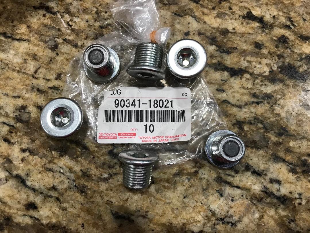

    I have also used the inexpensive $3 OEM 90341-18021 short Allen-head magnetic drain plugs in the R150F tranny and R100 Tcase on my '97 V6 Taco 4X4:

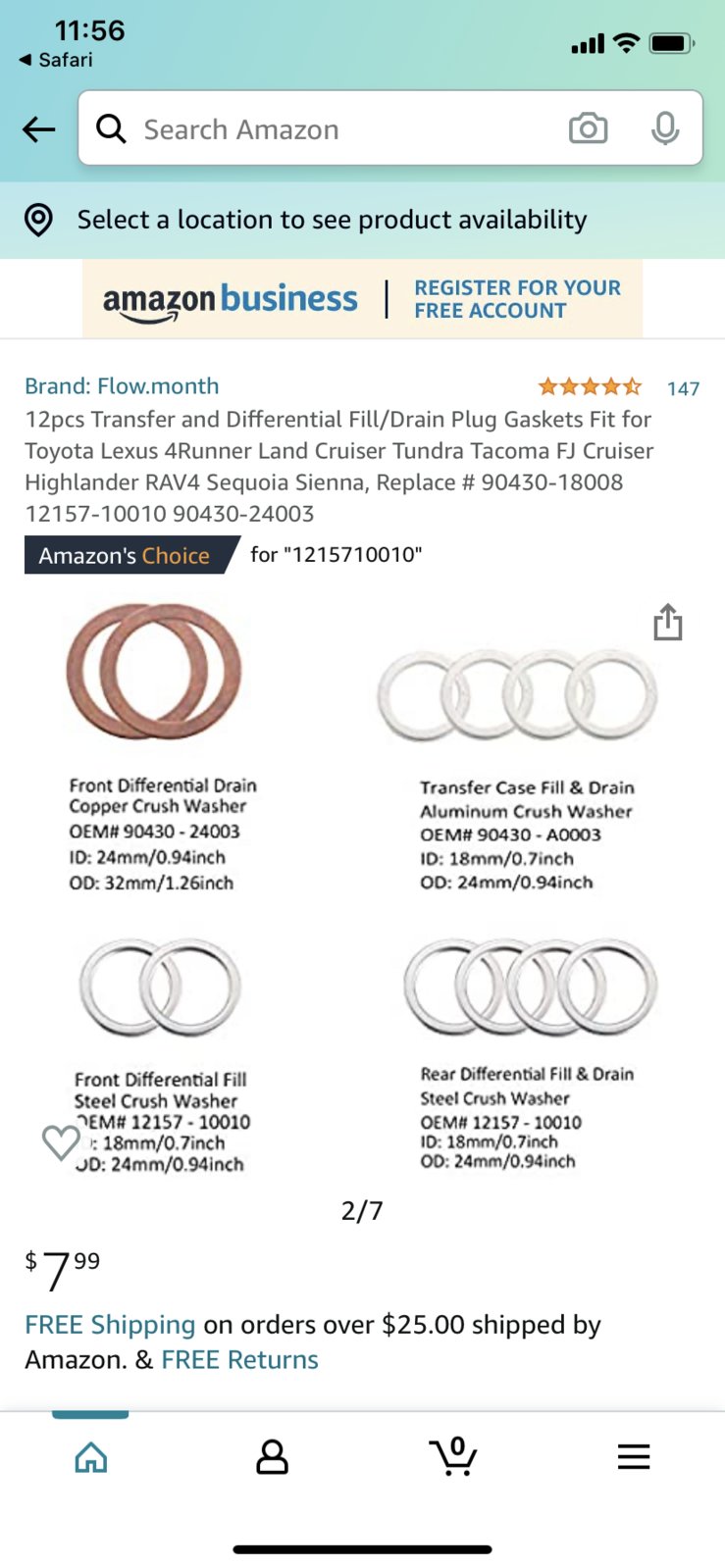

    Here’s the set I bought for my truck. Covers most everything if not all

    In Sicyota04's post there appears to be enough washers for two changes. Is that true? However, there aren't any Engine drain washers. Where can I buy a complete set of fill and drain washers for
    • Front differential
    • Rear differential
    • Transfer case
    • Transmission
    • Engine
    on my 1998 Tacoma and how do I know which ones go where (or does it really make a difference)?
    I prefer not to buy them from a Toyota dealer.
  7. Aug 5, 2024 at 9:13 AM
    Red_03Taco
    Red_03Taco Well-Known Member
    Nov 2, 2021
    #381170
    1,609
    Jerad
    2003 Tacoma Xtra Cab 4WD
    I've always just bought the kit Sicyota04 posted, and then bought engine oil pan washers separate (actually bought some rubber ones for the engine oil pan that spread out as you torque the drain plug down, and they've worked very nicely). Haven't found a complete kit that pairs engine oil washers with the rest.
    I usually just try to match up a new washer of the same style as what was on that particular drain or fill plug prior, but honestly I've switched some up on accident and it's never mattered for me.
