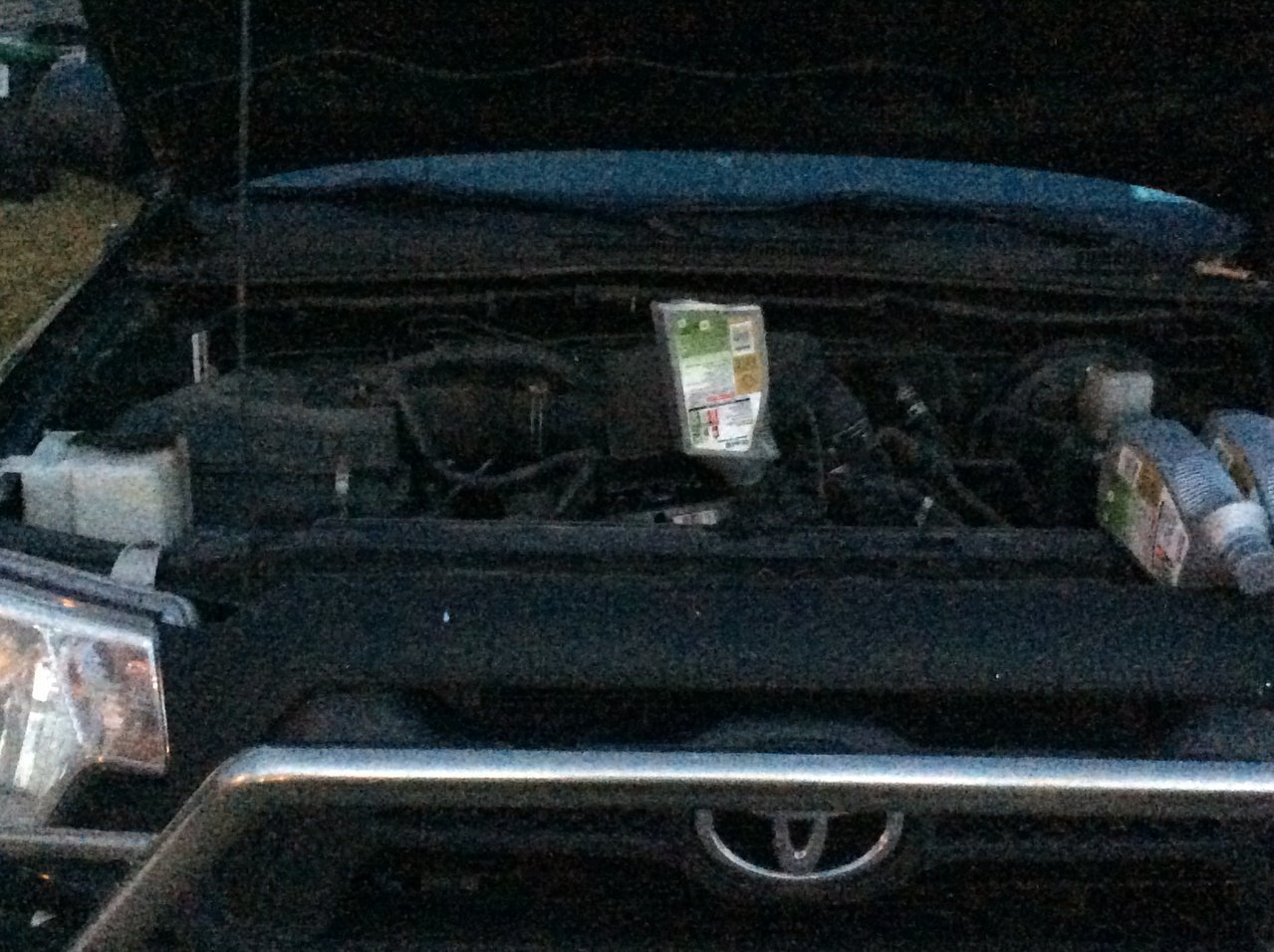

    BCDAFC7D-0BF3-42F4-89D9-B41EA0A87132.jpg I have another trick. I use the Mobil 1 0-20 and the 1qt bottle screws into the oil fil, I cut the bottom off the container and have a disposable funnel.

    2008 Access Cab 4WD, 2.7L 5 speed
    How to you empty the first container that you cut without a funnel to start?

    That empty qt container is grabbed from the recycling or from a friend's oil change disposables.
    Or cut a 2L soda bottle (wide body, narrow neck).
    Or just use a FUNNEL HAhahaa
