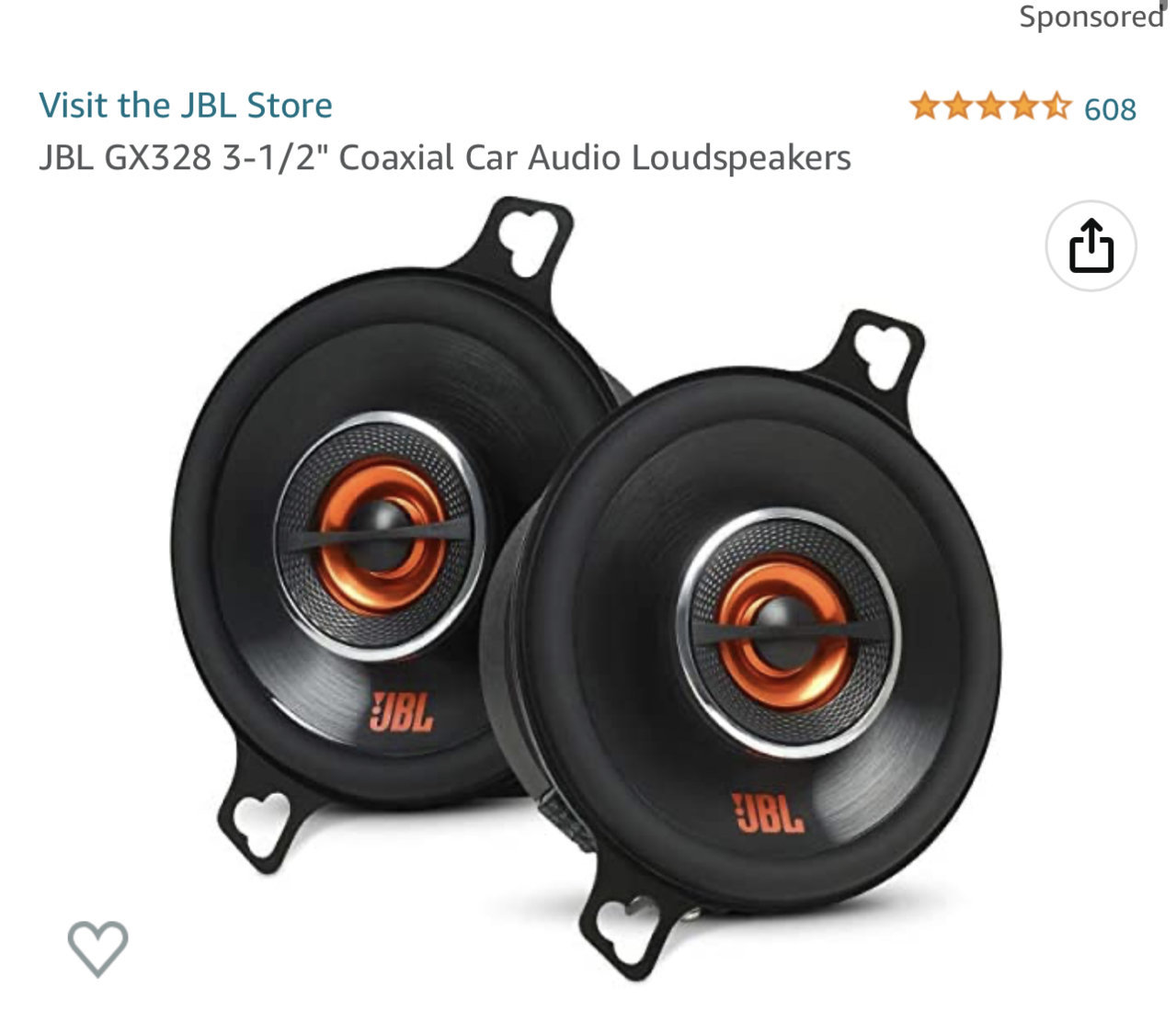

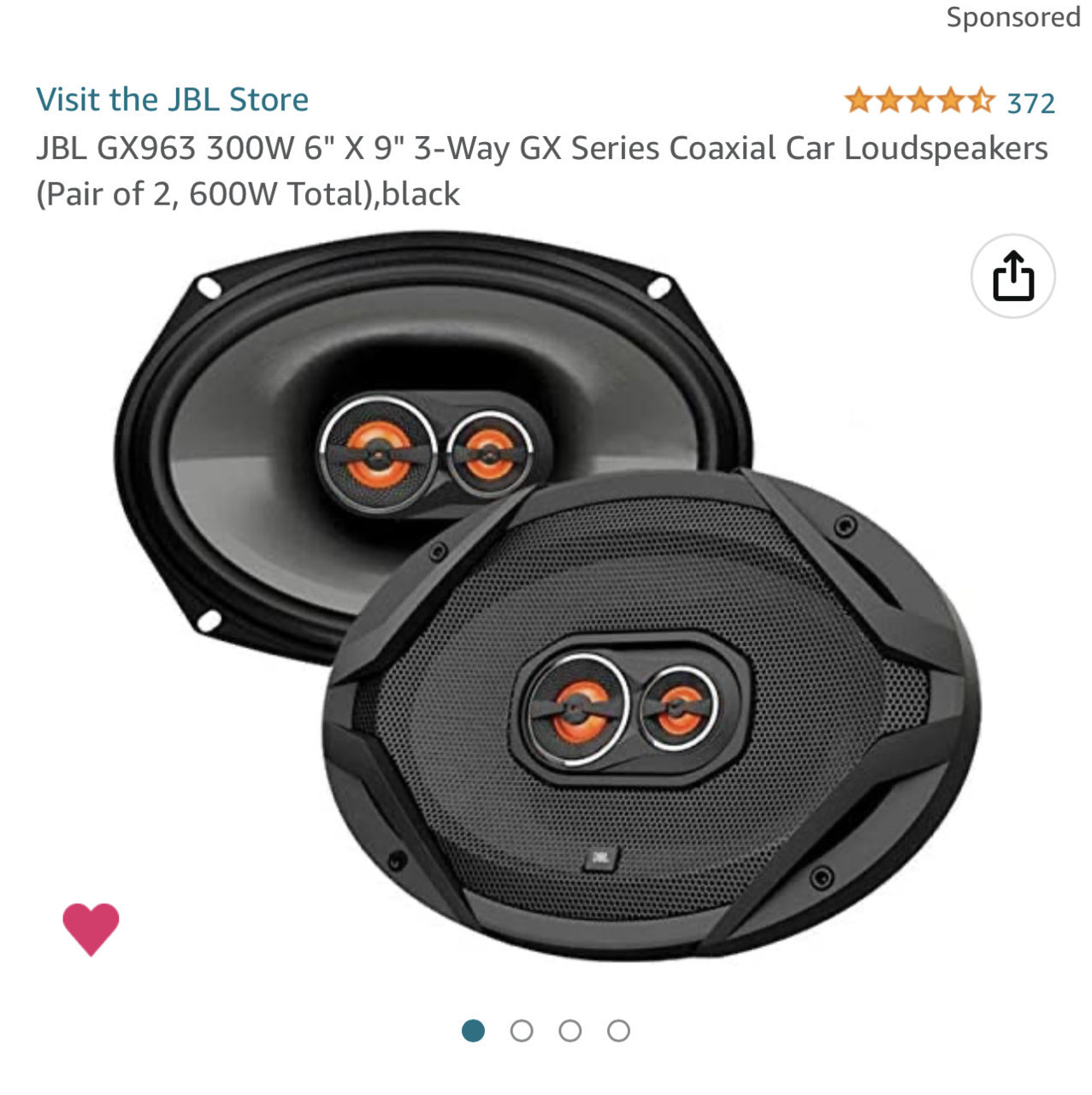

    My second question is, has anybody done a full upgrade to the speakers without amplification? If so, what have you use for speakers and harness wires?
    These were the speakers I was looking at and putting in my truck, but I would like some feedback.
    For the dashboard tweeters, I was thinking of using JBL GX328 3-1/2”
    for the front doors JBL GX963 6”X9” 3-way and for the back doors JBL GX628 6.5” 2-way. I have also attached pictures to the speakers.
    (Update) The JBL GX328 3-1/2” did not fit in the dashboard, so I decided to go with kicker tweeter speakers. I did still install the JBL 6x9 3-way and 6.5 2-way speakers and everything sounds phenomenal. Still using factory head unit for now. Here is the link to the kicker tweeter. https://www.amazon.com/dp/B00PV6F8I2

    For your next question, yes, I replaced all my speakers without amplification. There was an improvement in sound quality but not in volume. The factory HU does not provide enough power to push aftermarket speakers well.
    I ended up installing an Alpine Powerpack KTP-445U amplifier in behind the HU to power my Kicker DS Series speakers.

    If you only plan on replacing speakers, don't bother with the rears. Set your fader to the rears currently and you'll see that the factory radio doesn't send much back there.
    Knowing what I know now, if I have no plans to add an amp with the factory head unit I'd replace the tweeters and be done. The Infinity Reference 6x9 and 6.5 that I replaced do sound better, but only to my ears because I knew they were replaced and I was able to compare left to right channels while I still had the OEM speakers on place.
    The factory radio just doesn't have the power to make use of aftermarket speakers. They did sound cleaner but I lost volume and bass. I did add an amp so now they sound excellent. If you don't ever plan on adding an amp, find a speaker with high sensitivity that works well with lower power.
