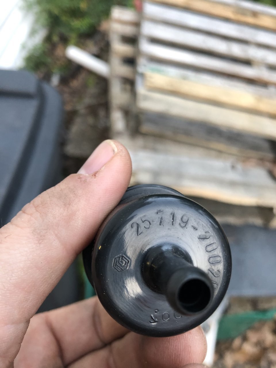

    Hey guys,
    Long time lurker first time poster. I’ve got a 2013 TRD Sport V6 MT6 and recently had the P0441 code popping up again. Usually only happens in summer with heat and I assume fuel tank expansion. I replaced the gas cap (last summer) and occasionally grease the gas cap o-ring. I just pulled the under hood valve solenoid and bench tested using a dewalt 18v, clicked and opened as it should. Also I do usually top off at the pump to round up and read to stop doing that so hope it’s not too late. My question is regarding this item that appears to be some type of check valve? When I pulled it off it’s a straight shot through. Should there be some type of diaphragm inside there? Seems worthless unless it’s for some type of expansion or something. Haven’t seen much about this in all the threads so thought I’d post up to see if this might be my issue? Thanks in advance. Token shot of a recent trip thrown in there for good measure. F8776804-2ABE-441F-9854-978DA89EFCF4.jpgAF0F9E05-89D4-4A51-A46E-B6776BE307C4.jpgA77BDC64-D02E-4795-B334-EF6BF3688800.jpgDD400F87-DB45-4E30-82F7-969823E34FEE.jpg

    Tires: 35/11.5/17 Toyo AT3s Wheels: FN FX Pro Gunmetal 17s with TRD center caps Zinc Metallic lettering. Yukon 4.30 gears with TruTrac Front Suspension: OME 887 w/5100s, Freedom Offroad UCAs n Superbumps Rear: Archive Hammer Hangers,Dakar Mediums, Bilstien 5125s Ubolt flip n Superbumps, Headlights: Selfmade Retrofits URD shortshift kit Airaid CAI No name throttle controller
    I just did and it's an original Denso valve with Toyota scratched off.
