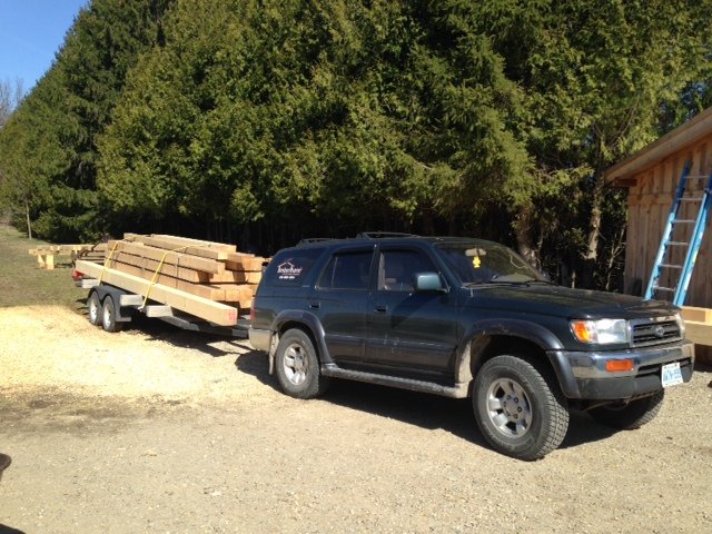

    8_7S-YgPvuOdHu27wRAOhHl27wIXnWSgZBBs_KmZ_66fb31097c18a190c11b79bb45ea403b983779bb.jpg .
    1997 4Runner rated for 5000lbs. Load weight: 6700lbs with electric brakes.
    The suspension is a bit soft for this but it pulls and handles just fine. Mind you I kept to back roads and didn't go over 50 mph.

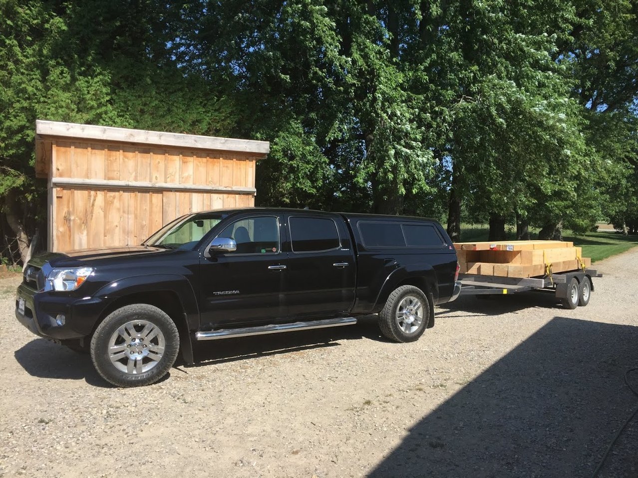

    I no longer have this truck. I have since upgraded to my 2013 Limited.
