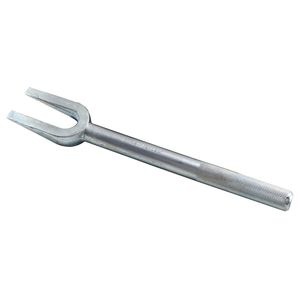

    hammer and a ball joint separator fork

    Depends on if you're going to try to keep the lbjs or you're replacing them. A pickle fork can damage them if you don't know what you're getting yourself into - I've read it enough times on here to believe there's at least some kind of learning curve. You can see for yourself how the arm puller is effortless when positioned right. @Timmah!

    I hate using the pickle forks. Put an arm puller works so well.
