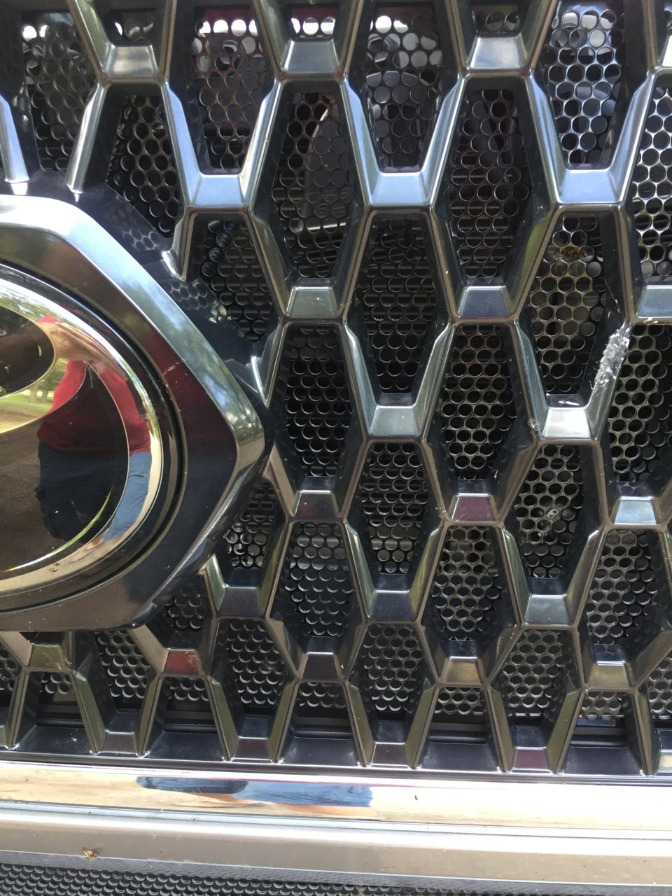

  20. Sep 10, 2019 at 1:02 PM
    #20
    wiljayhi
    wiljayhi “..ain’t nobody’s business if I do…”
    Oct 8, 2018
    #268685
    2,634
    Jim
    Murky Water, MB, eh?
    3G, Tuned
    Cloudrider bug screen. Black powder coated metal screen. Stops bugs & small rocks. A little pricey but well worth it
    Also comes with a piece to fit under the grill on the outside:
