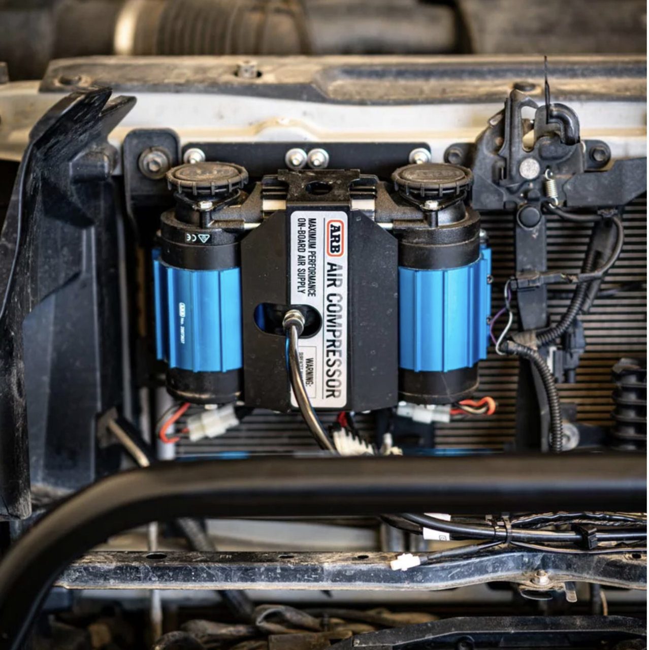

    There is another option under the hood, You can put it right behind the grill where temps are much much lower.

    I've seen a couple of them mounted here, atleast on the third gens. Pretty slick area if you dont have a winch or tranny/powersteering coolers in the way!

    Not sure about winch, but I know the mount clears OEM coolers (trans is on drivers side, power steering is at the bottom)
