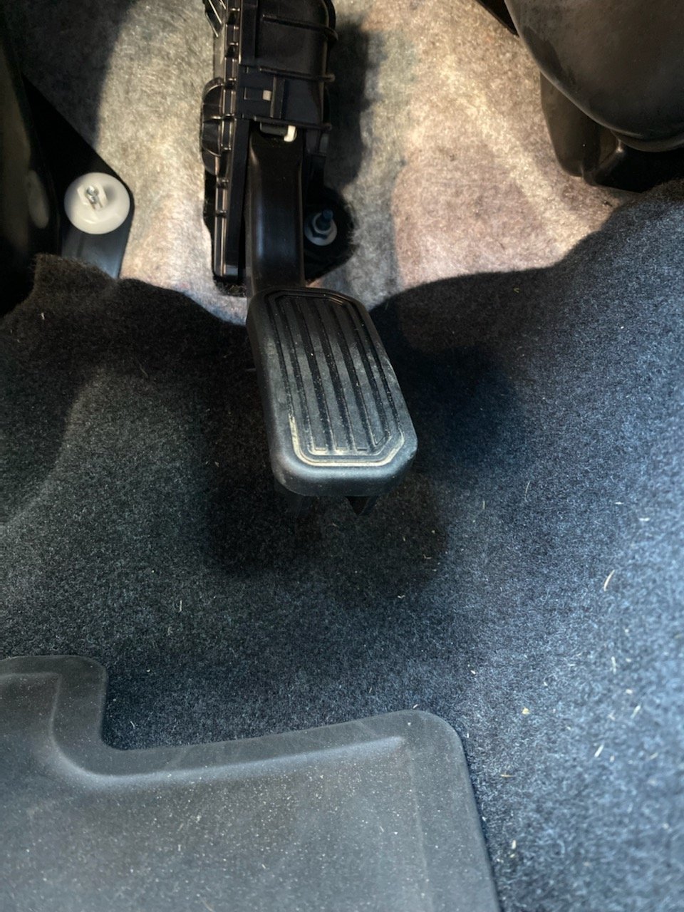

    Leave up on pedal then throw switch.
