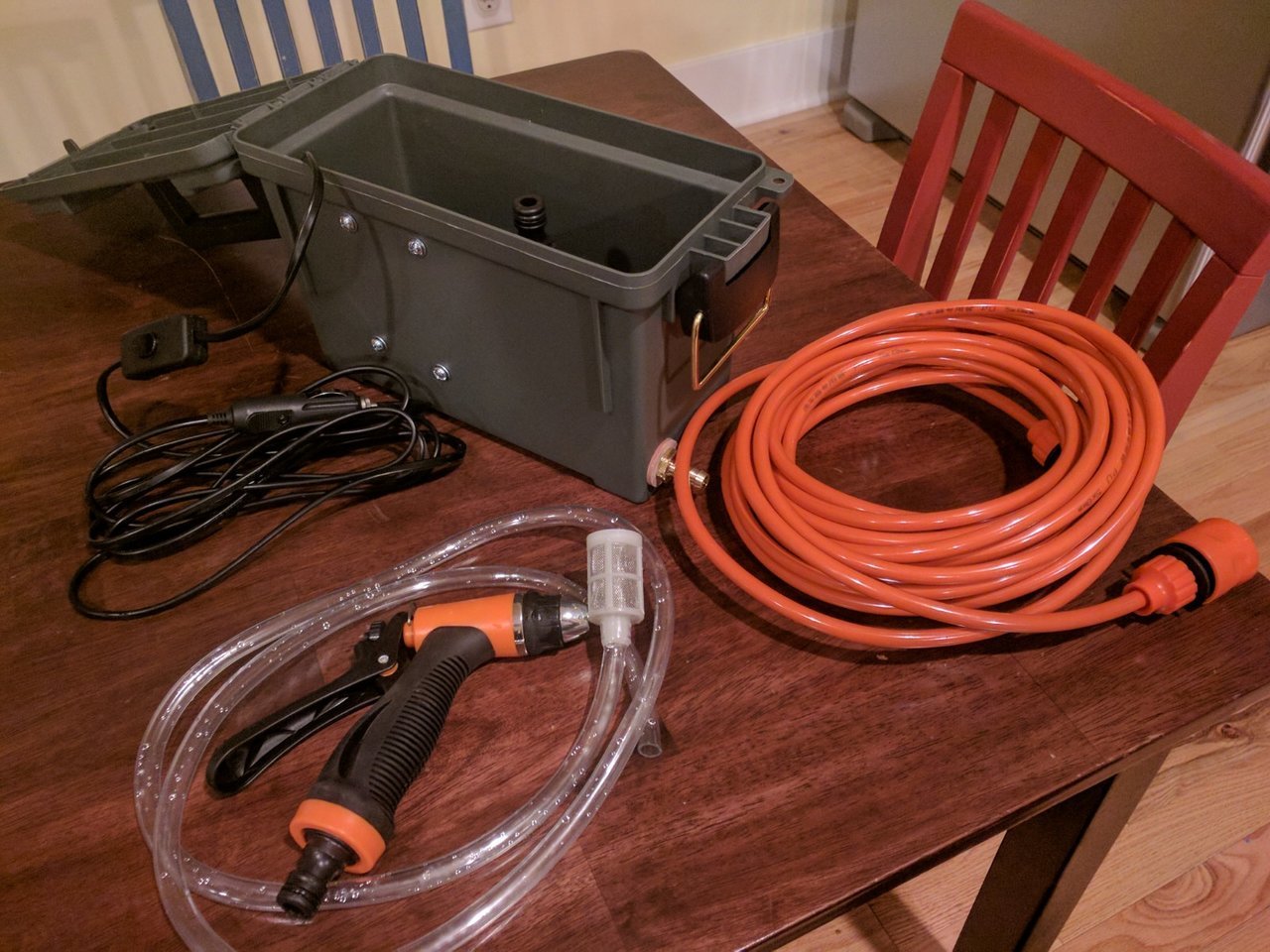

    I've been contemplating having on-board water on my Tacoma for a while. I came across some cool ideas and how-to's right here on Tacoma World and almost pulled the trigger on ordering a most-excellent kit. But I wanted to see if I could do something similar for less money, so I started researching. In my research, I was looking for the following in a kit:
    - Quick-connect for the hose nozzle
    - Quiet operation
    - Pressure switch
    - Reasonable AMP draw
    - Flexibility of water source
    - Simple and effective storage solution
    - Portability
    I believe I have delivered on these things. I would have actually preferred slightly less water pressure to conserve water, but that can be controlled by the hose nozzle. I would have also liked a lower wattage (I believe mine is 70W). But all in all, the price is right and the DIY aspect is minimal, as the pump was purchased as a kit, and all I did was mount it in a box. The best surprise came when I tested it: It was extremely quiet. I was also able to fit it all (although with a lot of fussing and Tetris-like skills) inside a small ammo container.

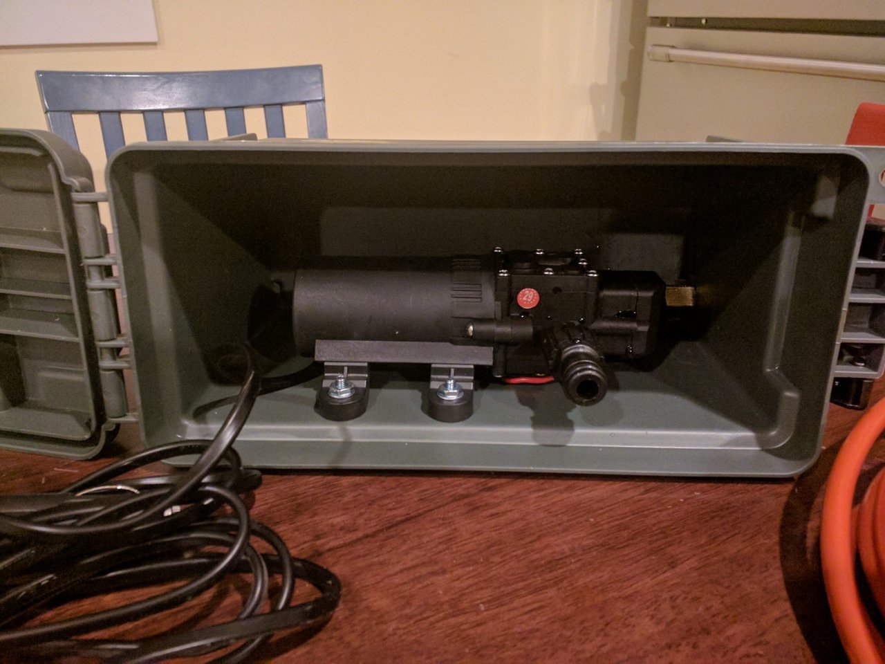

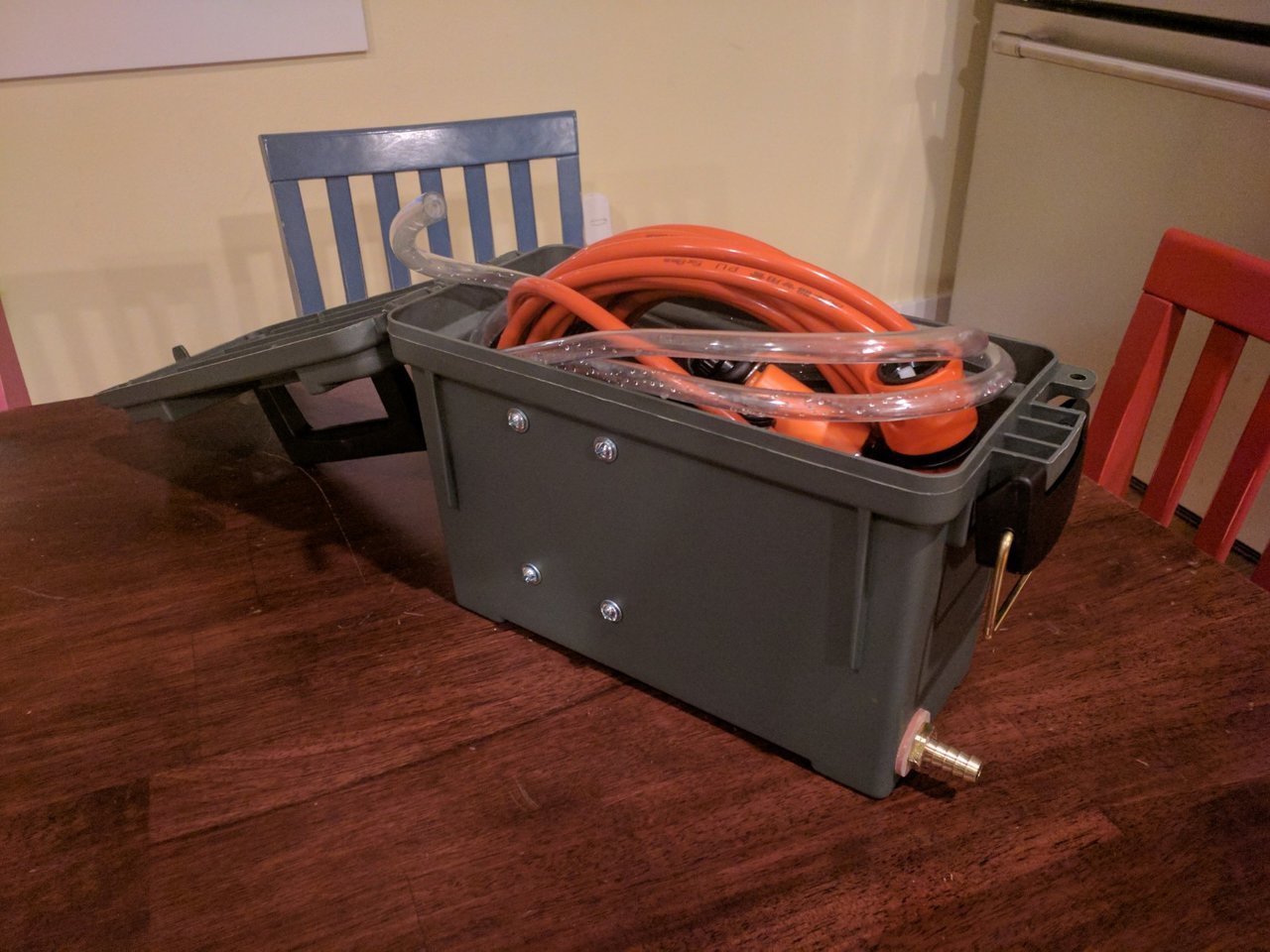

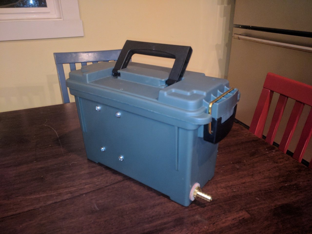

    Assembly: I mounted the pump on the SIDE of the Plano ammo box. I aimed to center it on the side wall, with the quick connect for the hose facing upward. The Brass fittings I mated together in a hole on the lower front of the box. I cut about a 4" length of the feeder hose and permanently connected the pump to the brass fittings. I also drilled two small holes in the "feet" of the ammo box to let water drain out. It's a tight fit, but I am able to cram everything inside. The only down-side is that I was unable to find plumbing fittings to route the hose disconnect to the outside of the box. This means you have to have the box open to use it. That being said, the current setup allows me to do it in the future if I am ever able to find proper elbows and fittings.
    Note: Don't go by the chairs for scale - those are toddler sized. :D
    Here is how it looks all buttoned up:
    Once you loosen the top, you can see how tight of a fit it all is.
    All the removable bits (it looks wet because I tested it):
    How the pump mounts inside the box:

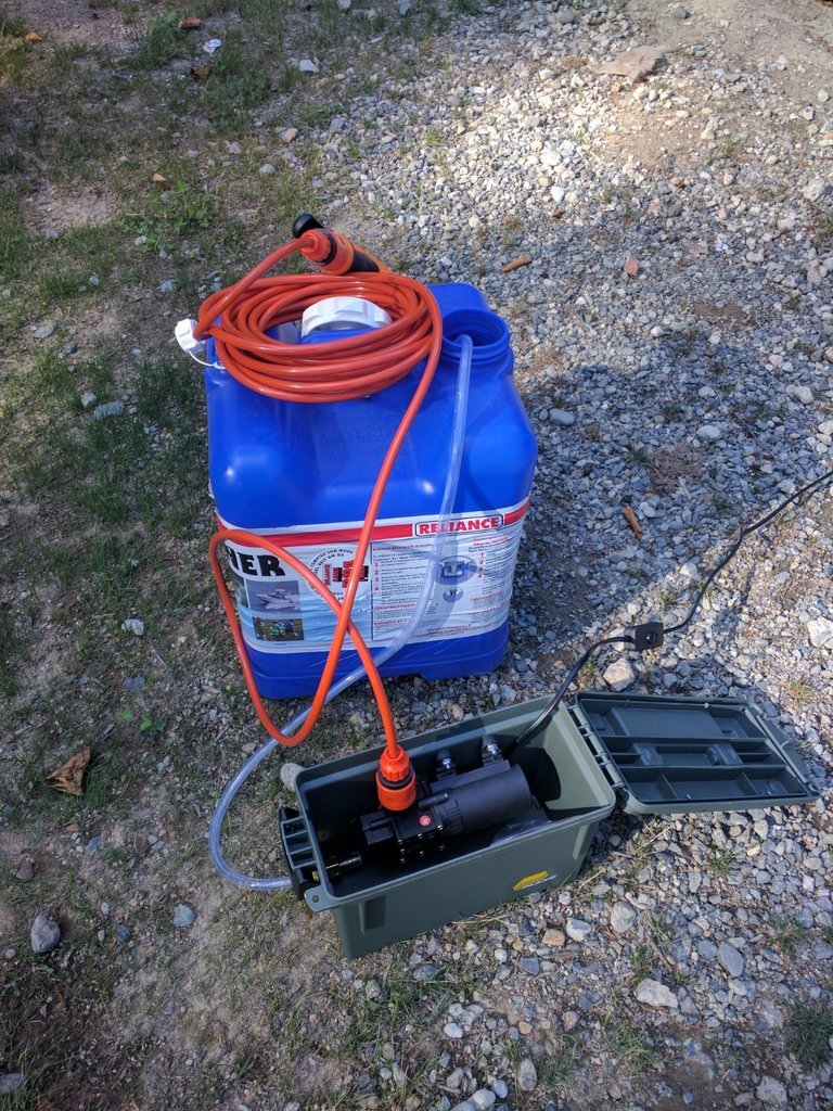

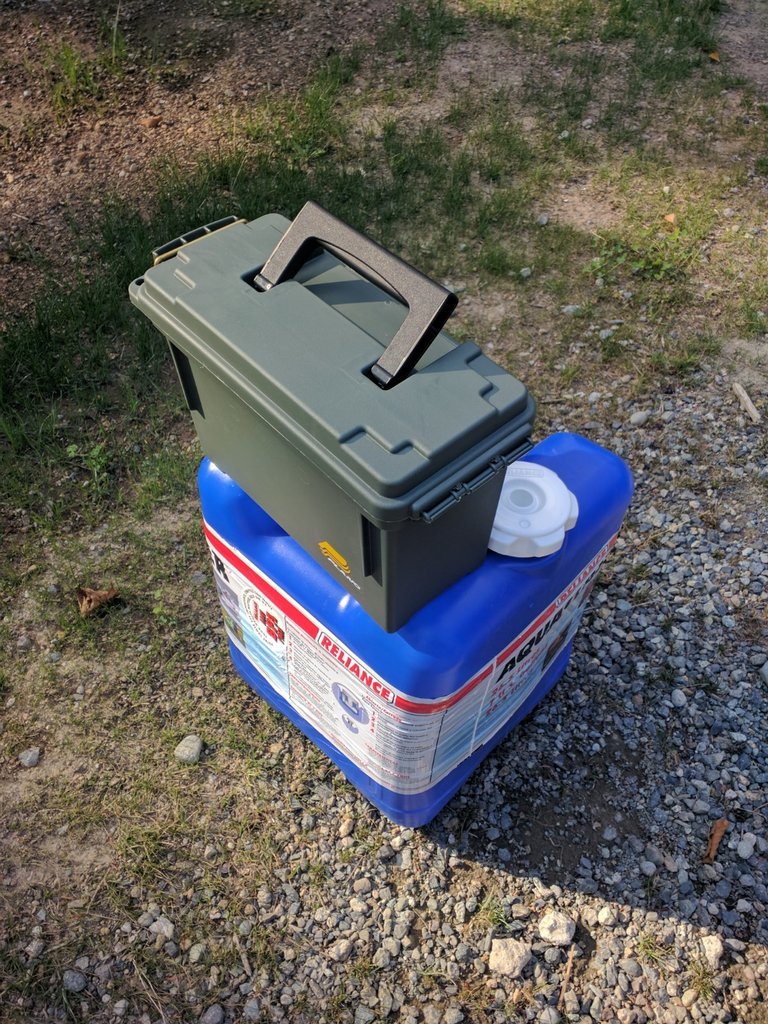

    Edit: Now that it's daytime, here's some more photos of the thing all set up:
    Everything all hooked up:

    OP updated with some more photos and a video. It sounds awful loud in the video, but you can judge by the loudness of the running truck... seems to be about the same. I was really expecting this to be obnoxiously loud based on other videos I've seen, but it's actually not so bad. The idea behind this project was to come up with something flexible for those on a budget. As you can see, the entire thing can be had for under $45 and can use just about any container for a water source. The hose is pretty long and I've considered cutting it down, but I wanted to keep the amount of work down to a minimum - I have much cooler projects in the works.
    If you have a drill and a pair of wrenches, you can do this project. :D

    The portable box I just made has approx 10ft of power cable and 25ft of hose. The AMP draw is between 5 and 6 amps. There are some cheaper carwash pump kits but they are higher pressure/wattage. This was the lowest draw pump I could find as a kit. As for water... On my last trip ... which was about 3 days, 2 adults and 2 kids, I had the 7 gallon Aquatainer, 2x 2gallon drinking water jugs, and 5gal Rotopax containers. We ended up using one of the 2gal drinking containers and I emptied out the rest. :) That's why I think 15 gallon container is probably just about right (for me), if an occasional shower and daily dish-washing will be involved. Again, your mileage will vary on number of people and how much water you end up using. That's already 120lbs or so, so I'd be hesitant to go too large.
