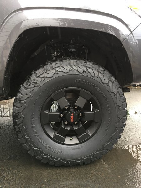

    3" revtek leveling kit 285 75 r16 BF Goodrich KO2 TRD wheels (Toyota FJ trails edition) OEM official Toyota product
    I do have a lift similar to yours. I have the 3" revtek leveling kit installed by Toyota. I run a 285 75 16 tire with no rubbing or cutting required.

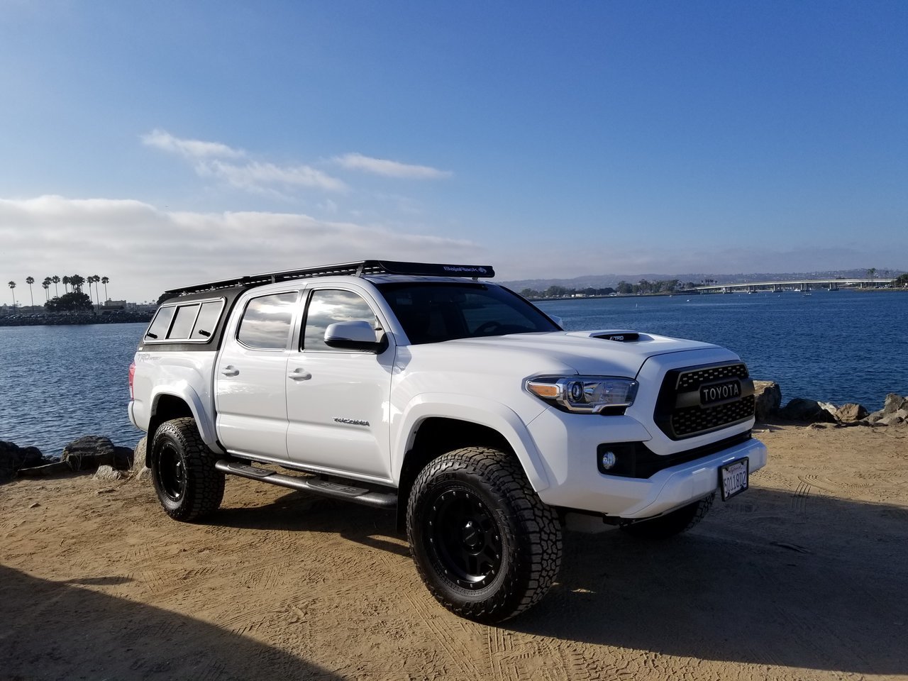

    Here you go. 17x 9, -6 off set wheels. 285/70/17 Falken at3w's. Pro Comp 3/1 nitro setup. I like it so far. Rides like stock to me on freeway. On a bumpy back ally I think I feel a tad more but just go slower. I feel a lot more higher off ground than stock.

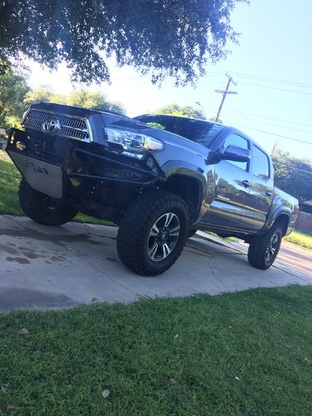

    - N-FAB RSP front bumper - 3" Bilstein 5100 coil over & suspension up front - LR UCA's - OME AAL & suspension in back -Ion Alloys & 285's to sit on - Trail Gear Sliders welded to frame - Rago Bed bars & hilift
    Planning on getting the same done this coming week. How do you like it?
    Running 285s bought the 3" 5100 Bilstein lift kit and 888s like he suggested. New UCAs And rear AAL. From headstrongoffroad.com
    Love it.

    No rubbing at all without mudflaps. I drove it without mudflaps for awhile. Recently put on some Plasticolor mudflaps from my local O'Reilly's and when my wheels are almost all the way turned as in making a u-turn they just barely rub but nothing that damages anything. Everything is still there. Here are some more recent pics of me after driving some pretty gnarly trails out in anza borrego, ca.

    Eventually I'm going to go with icon stage 4 but figured I would save some money for now. Just bought truck in December and have already spent a good deal on accessories. Plus might as well use the suspension (shocks and springs) I have for now since they are new. This entire setup (lift kit, falken tires, and wheels cost $1500 with me doing the labor myself). I was at 4 wheel parts and they sell same setup using Procomp Tires instead installed for $3000 which they sell to a local Toyota dealer which marks up their trucks $7k. So for now this will do.

    Wildpeaks. I also just swapped out rear to 2 inch blocks due to weight of camper sagging the truck. Now its level again with 3 up front 2 in rear.
