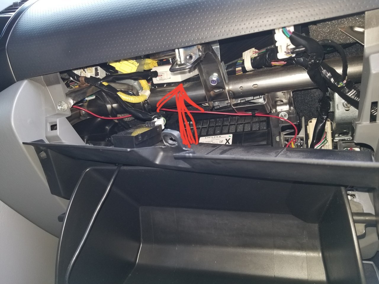

    I bet you didn't get one of the pins on the blend door arms in the track the actuator attaches to.
    Did you check all the wires on the back of the radio?
    Did you plug in the Door Control Receiver?
