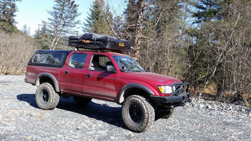

    The 16x8 will fit fine with some trimming of the pinch weld. I cut the fender liner and took a hammer and angle grinder to the pinch weld. No rubbing there or the frame, but I do rub the washer fluid reservoir. I'll have to relocate that, but no biggie.
