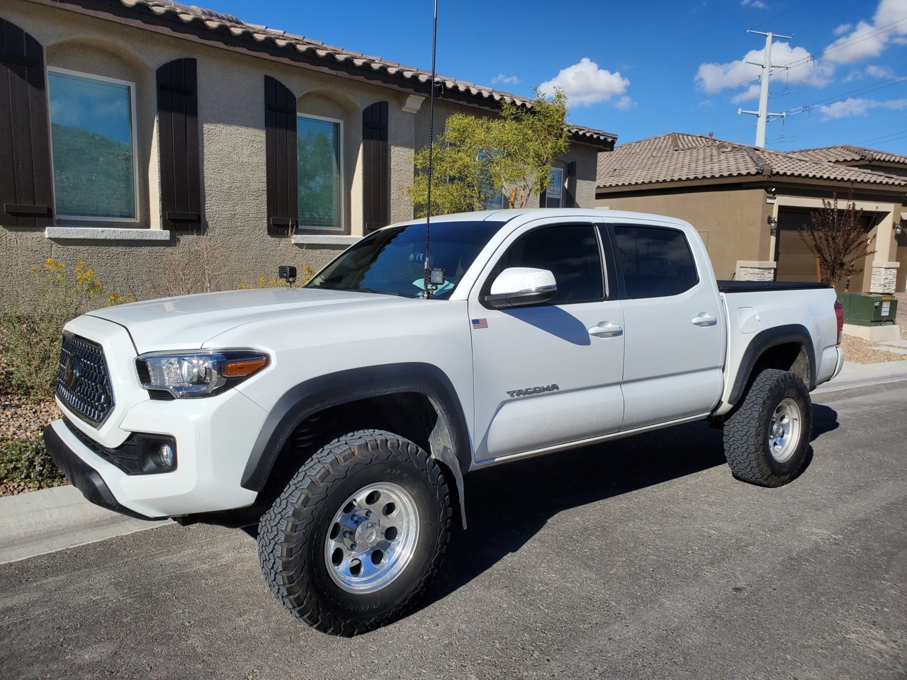

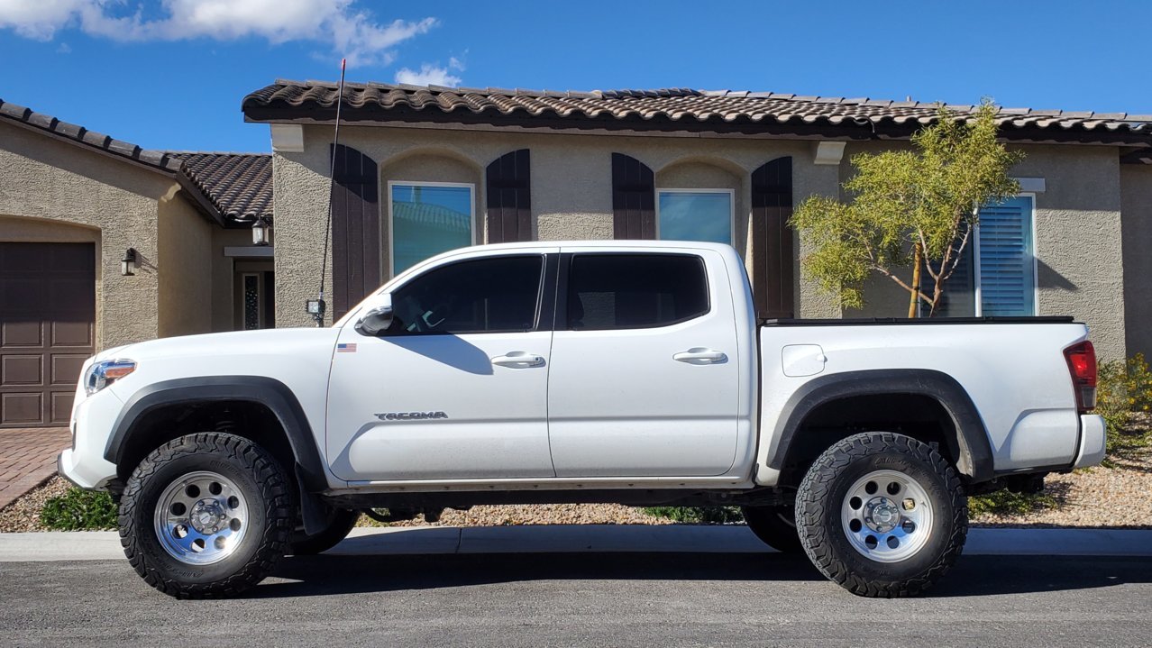

    I have the polished ones with 265/75 r16 ko2s. It's close but they clear the caliper. Minor rub and had to trim plastic. I have a 2" lift but added spidertrax spacers and needed a cmc. I didn't need the spacers for the wheels to fit. Just wanted them.20200316_163820.jpg

    I purchased 17" for my third gen just to be safe. The images of the 16" barely clearing the caliper looked too close for comfort for me
