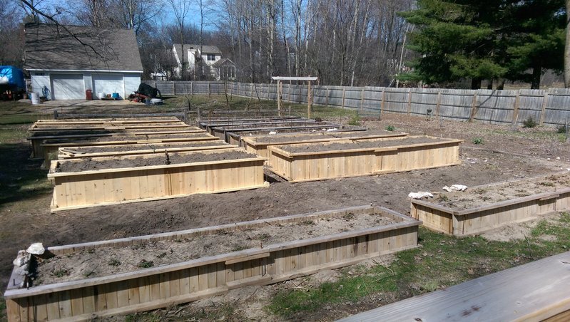

    This privacy fence is 10 Years old. We naught the prebuilt panels, sank the post and attached. It took 2 days and some change.
    The lumber yard dropped the panels off around the perimeter so we didn't have to haul the panels very far.
    There is no way you will save building your own panels. Time has value.
