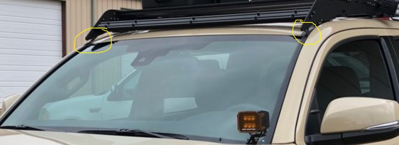

    Truck is in the shop right now, but here is an old photo:
    The circles are where the wires start going down to the pillar.
    - Pry the weather stripping on the side of the windshield. It should come off fairly easily.
    - I suggest you place a towel on the windshield and pry on the windshield side, not where the pillar and strip meet.
    - When you put the strip back on, apply clear silicone where the wires go in to and out to make sure no water gets in. The same one you use to install the bolts of the roof rack works fine.

    Damn this is EXACTLY what I'm going to do, and I really appreciate the additional detail and quick response.

    Here is a better picture of how my wires go down:
    If you are only running one set of wires, I think you can get away with not even taking the strip off. I have two one side and three on the other so I took strips out, butted the wires against the pillars and put the strip back on while making sure the wires don't move. I still applied clear silicone where wire started to go in, but honestly, you don't really have to since the glass should be watertight.
