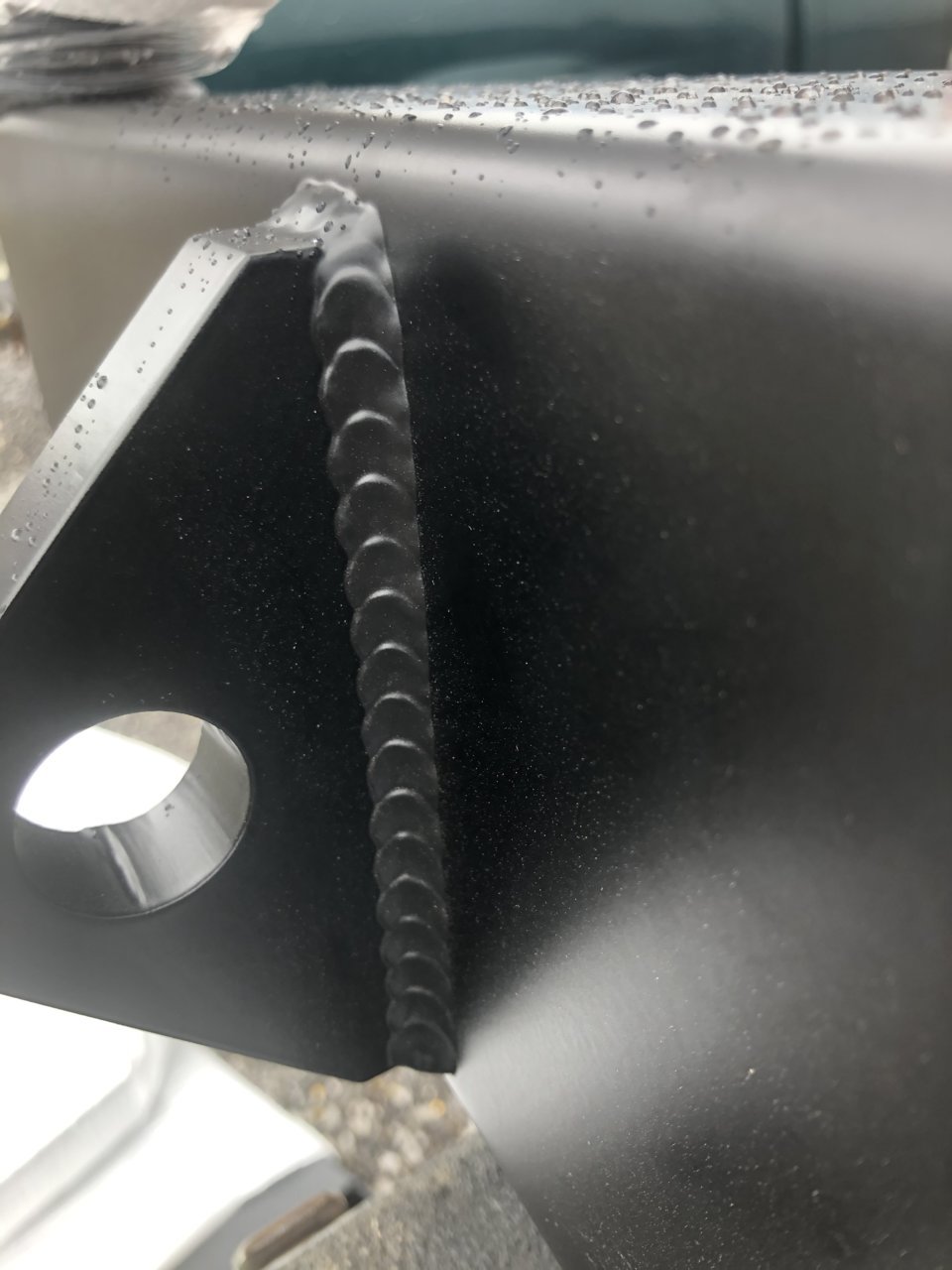

    With CBI, you definitely get what you pay for. I just picked up one of their swing out bumpers and the welds are some of the cleanest I have ever seen and I work offshore and have came across a fair share of guys that can lay a bead. I agree, it’s expensive but the quality is definitely there.

    Oh I know. I have their DIY front bumper, and while my welds are not exactly up to CBI's quality, the metal they sent me was top notch.
    That said, I don't really care enough about dime stacking to pay over a grand for a bumper. I'm a grinder, not a welder, lol
