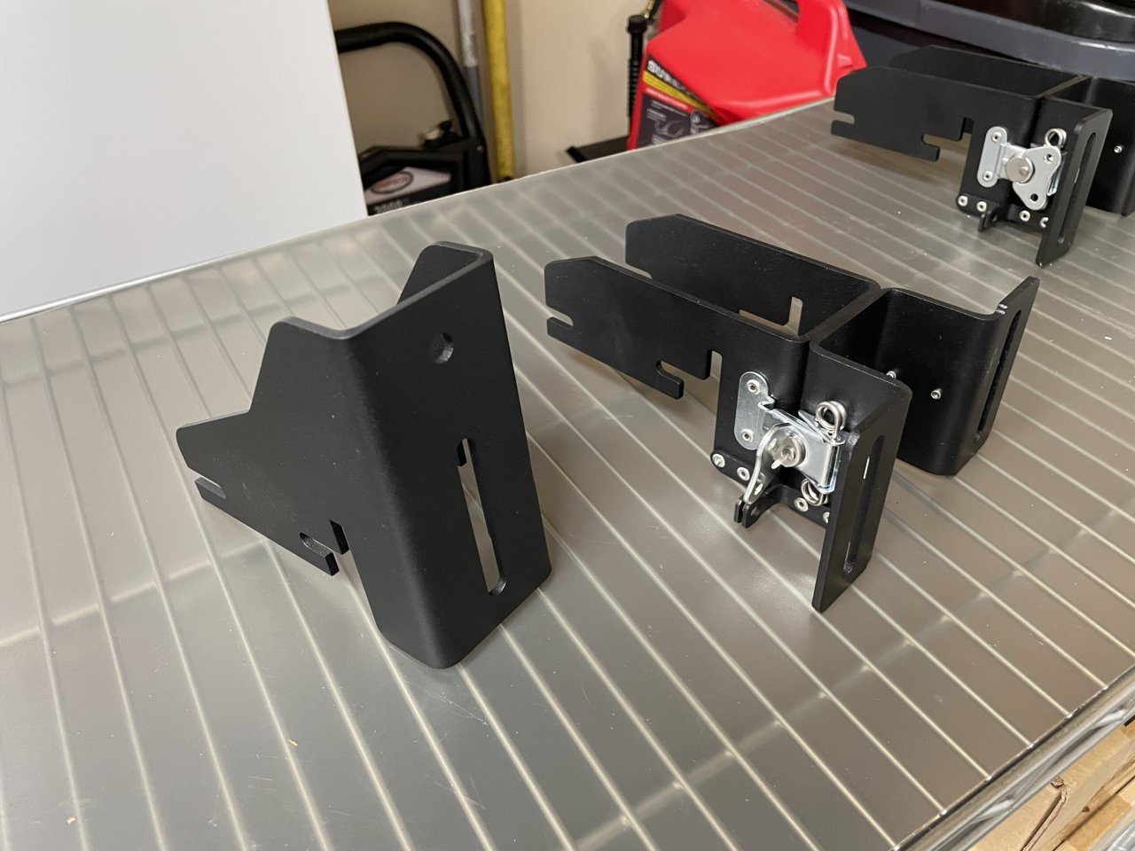

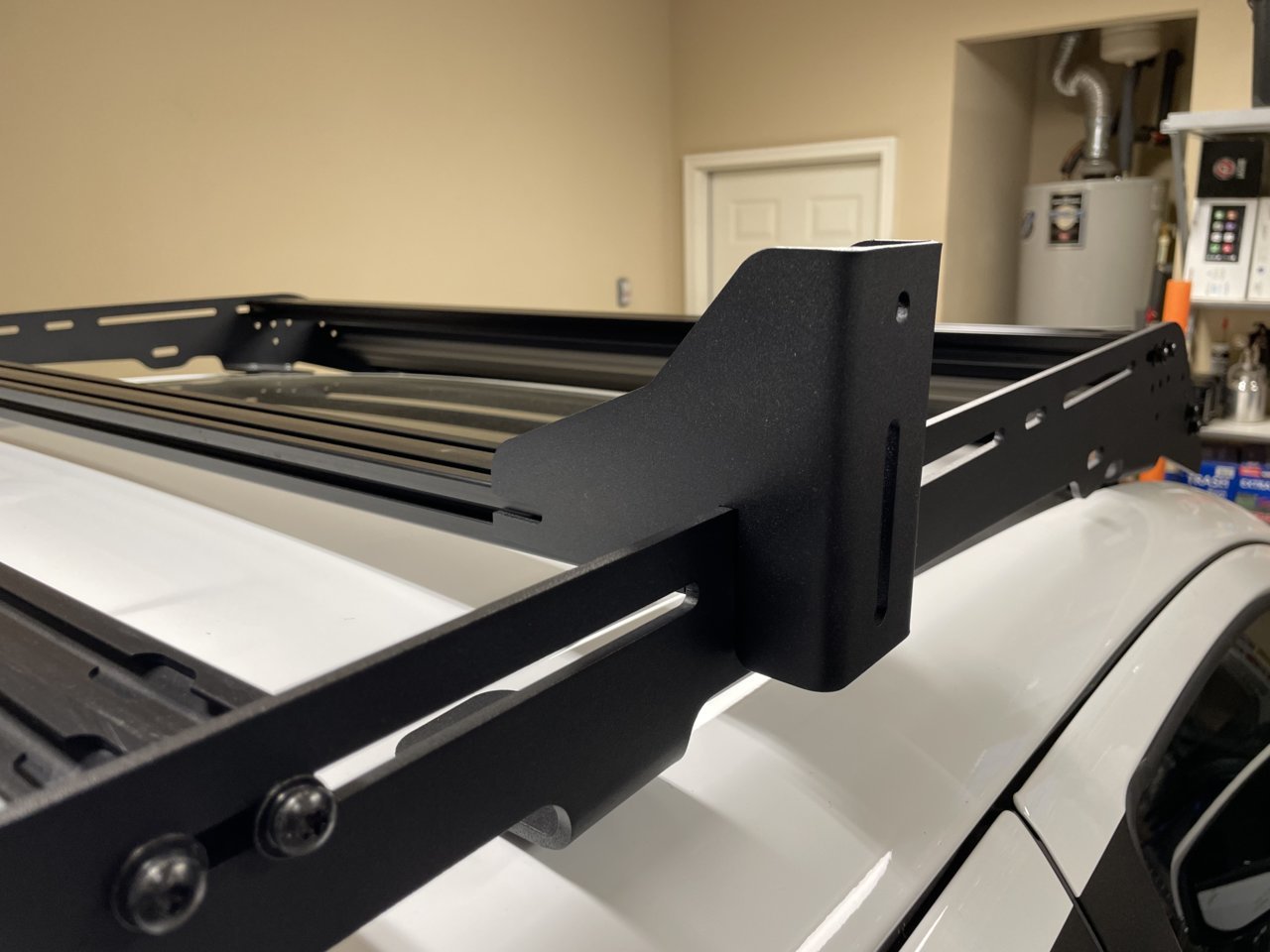

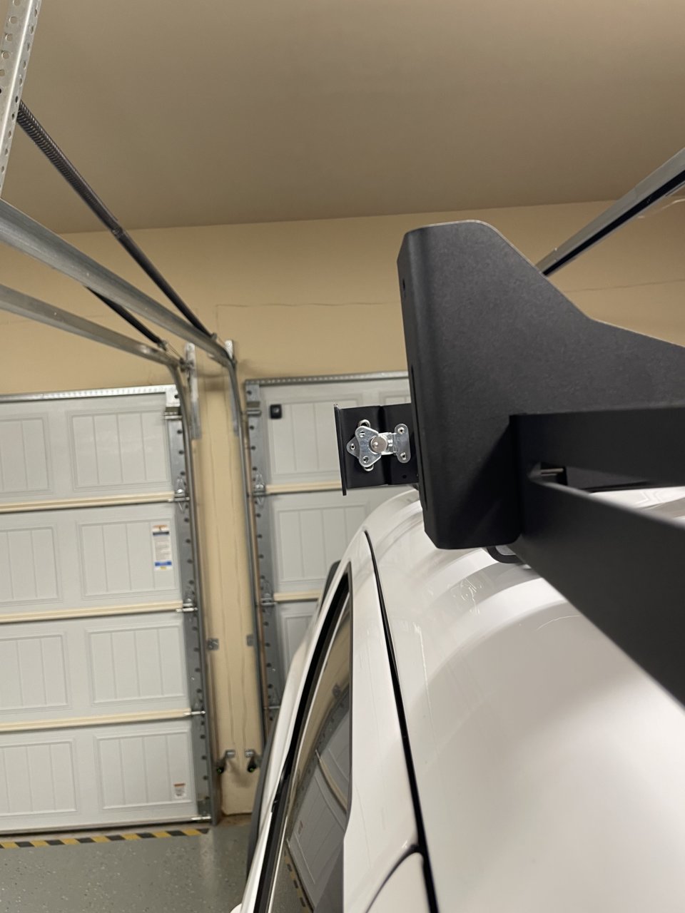

    In case anyone wanted to see what the Prinsu Awning Mounting brackets vs the Prinsu Quick Release Awning Mounting brackets look like on the Prinsu rack, I have pics of both. I ordered the regular, then when I got them, I decided that the quick release ones would be a better fit since I probably won’t have the awning on the truck 24/7.
    Anyway here’s a few pics for reference:

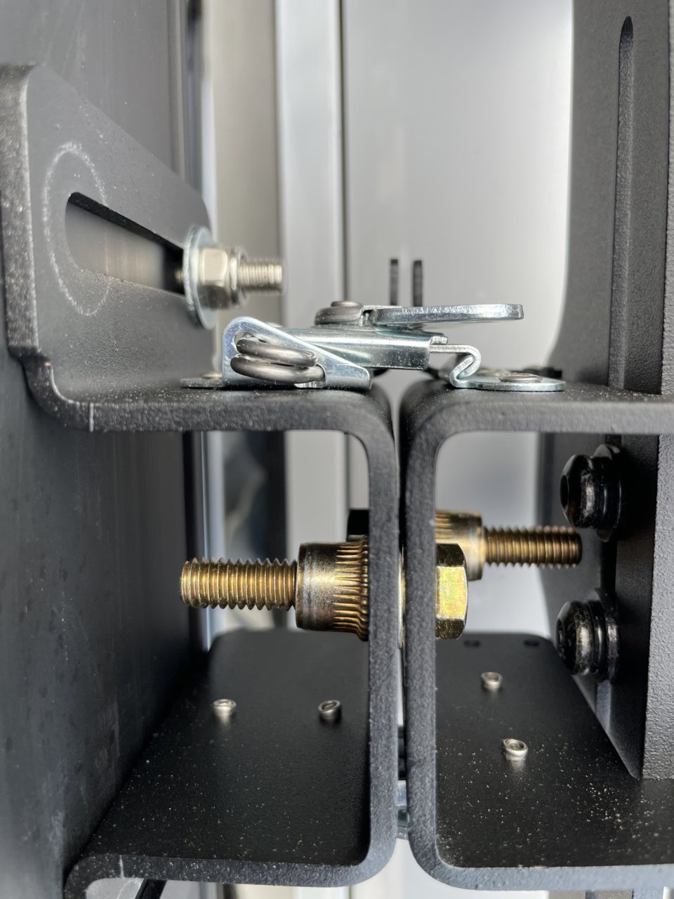

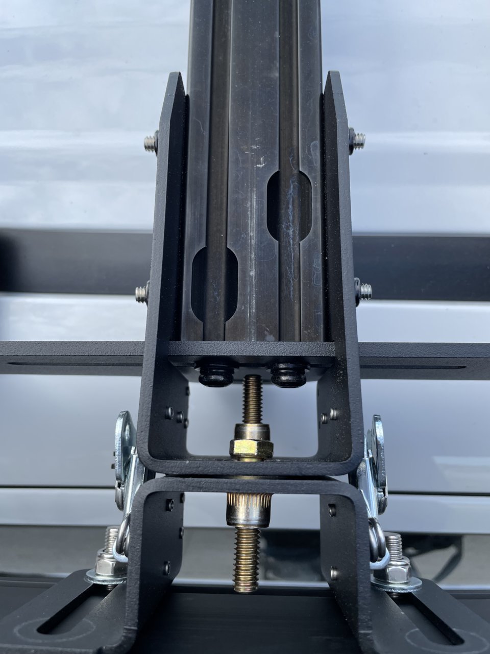

    It may be too early to tell, but I’m not seeing issues with the latching mechanisms. There are two bolts that are supposed to be tightened snug that act as alignment of the two pieces of each of the brackets. They supply thread locker, but I may add a locking nut on the backside of each bolt since I found that I was not able to align the different pieces if the bolts were snugged down completely.
    When I was looking at awnings and mounting brackets, I could not get a clear picture on what the different mounts looked on a Prinsu rack. I thought I would set both up on the rack so people could see how they look and how far they sit off the rack. I went with a 23Zero 180R Awning and I can take it off in maybe 5 mins. Of course added convenience means reduced security so a thief could also snatch it off in 5 mins. I plan on looking into locking options soon.

    I took another couple pictures of the bolts in question

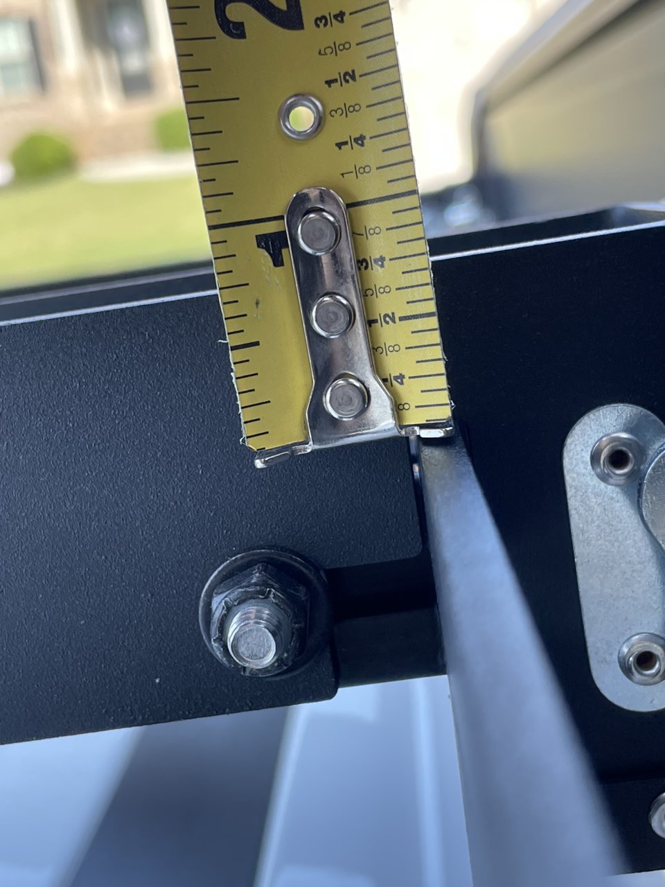

    Been considering the same setup for my 4Runner. I’ve got a Roofnest Condor tent on my Prinsu and looking for a low profile awning bracket that would work with the tent when it’s opened. Any way you could measure how much the bracket extends past the top of the rack? (See picture for reference)

    Would it make sense to consider substituting your own bolts with lock-nuts in place of the RivNuts? I'm not a huge fan of RivNuts to begin with and they look questionable in this application.
    Looking at the assembly, I also think that adding a small alignment lip on the awning bracket that would go over the top of the rack bracket might help with quick installation.

    I am confused on how the QR brackets work:
    • You have the silver latches on each side to snug it down
    • But then you also have two bolts that have to be tightened down?
    Sounds part quick release and part "manual tightening" and the manual tightening is in a tight space.
