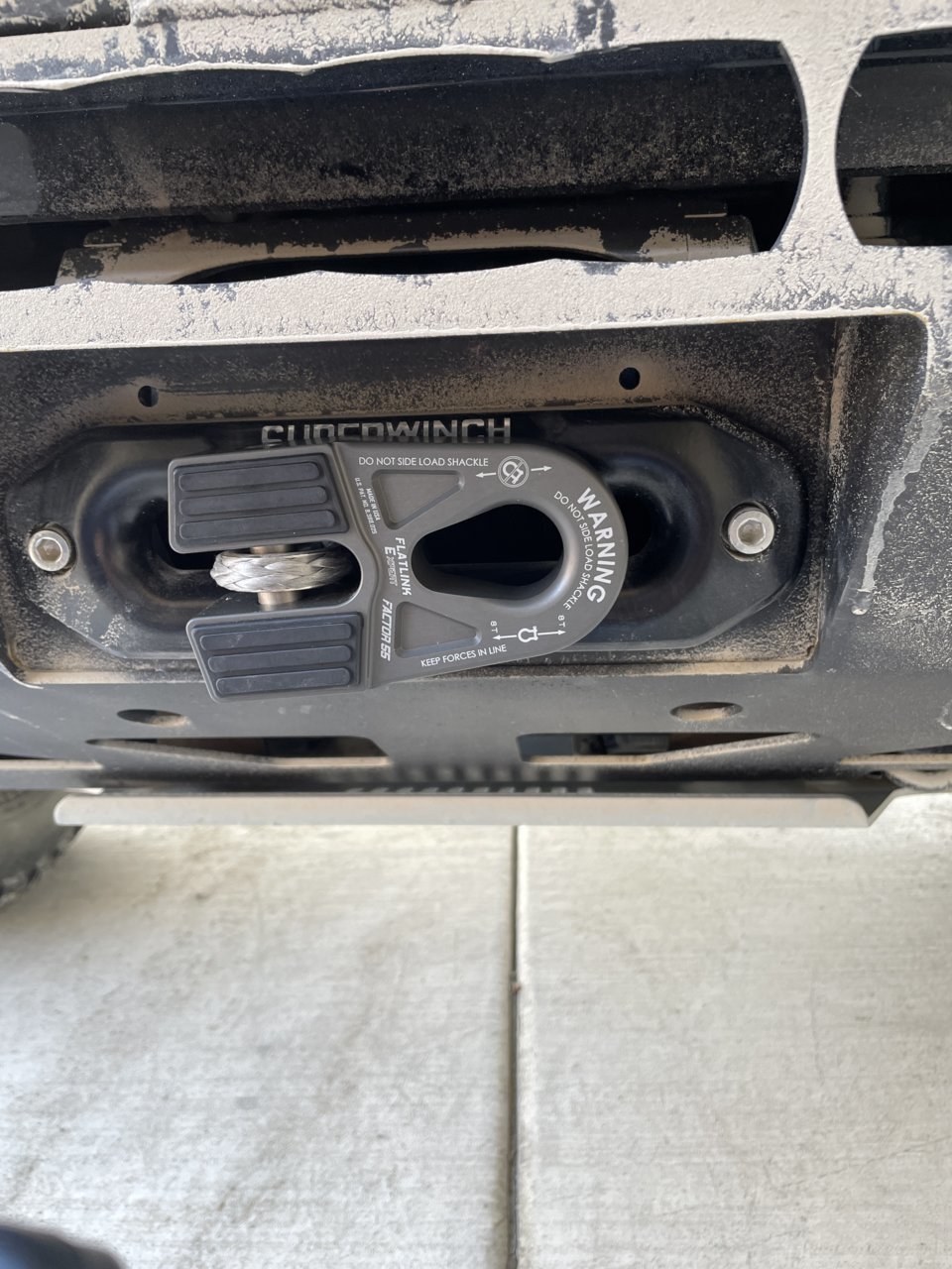

    I wanted basically the same thing so I went with a factor 55 flatlink e. The prolink stuck out to far for me and the ultrahook was too much hook for my needs.
    I reel mine in all the way with the chafe protector on it... what's the harm in doing that?

    Probably nothing, mine wouldn’t fit through the fairlead so I figured others would have that problem as well. Apparently I was wrong.
