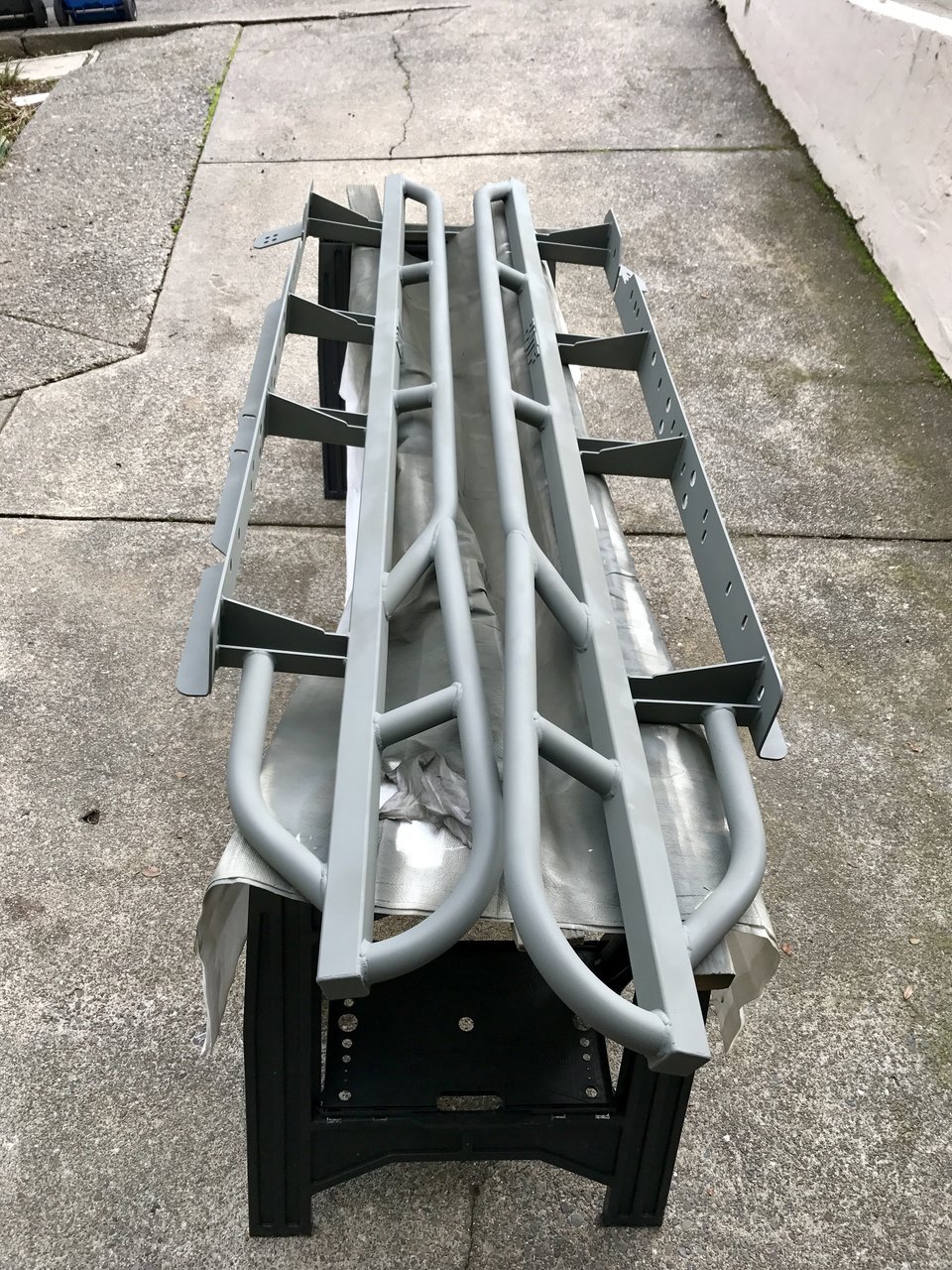

    Marin, CA
    17 DCLB
    list is growing fast
    Do at least 2 coats of each. Follow instructions on cans. Good to go.
