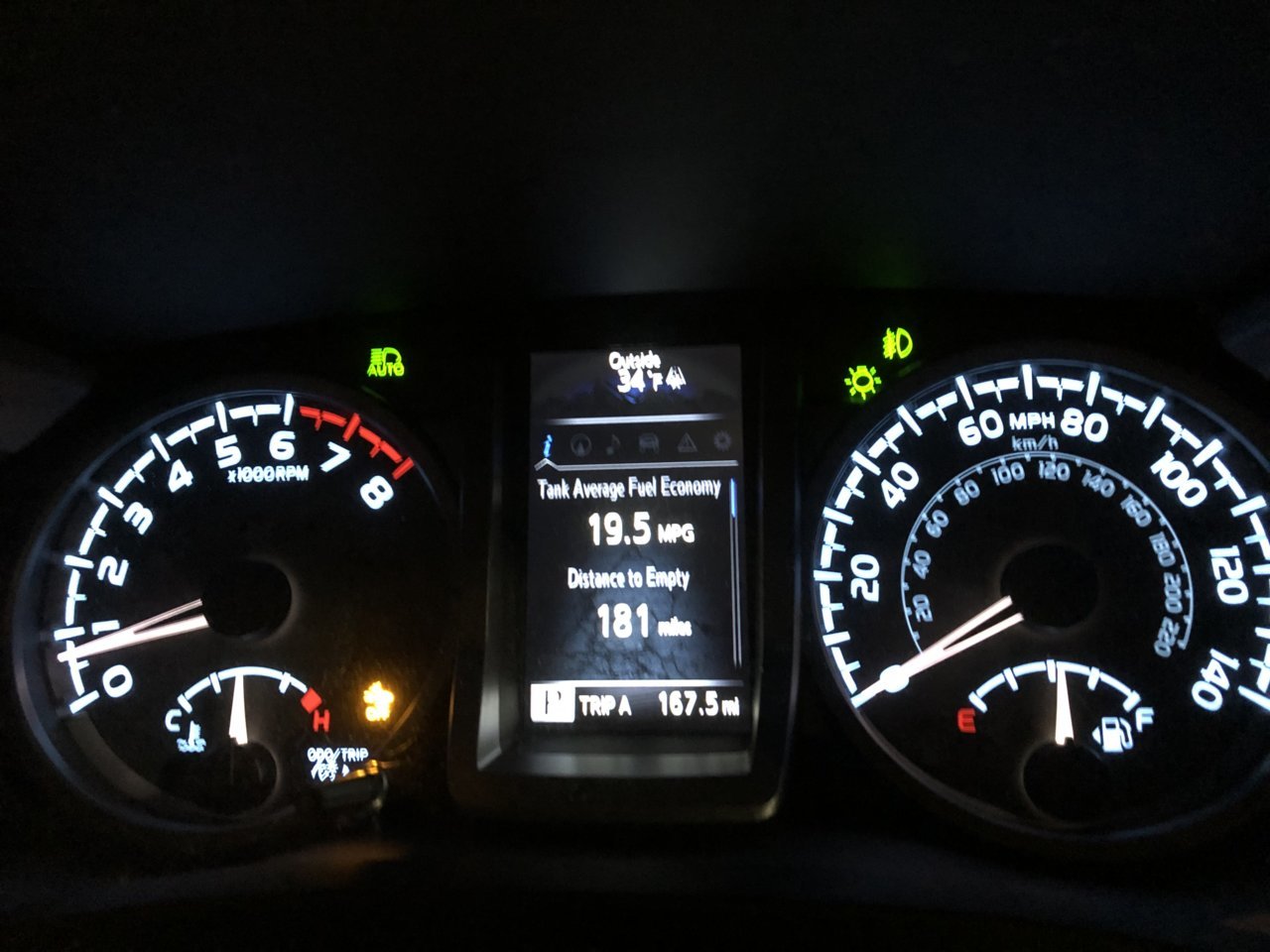

    I have a 2018 DC Sport, with practically speaking no modifications. Factory suspension, grill, lights, . . .
    Earlier this week during a little bit of a snow squall my PCS light came on while driving on a limited access highway. There was snow on my hood, and quite possibly on my grill, definitely on my roof. There were other vehicles on the road, and as usual the slushy blend of snow and anti-freeze chemicals that PA uses was creating a dense spray all around. I pulled over, shut off the truck, turned it back on, and the light cleared for probably half a mile, then came back on again. According to the Owner's Manual near the end of the section, one cause of the light could be road spray, very heavy fog, or snow. So, these were possible, but I've never seen it before, in heavier snow for instance. Fortunately, it cleared itself over night, and with cold sunny weather restored here, has not returned.
    I guess my question is, has anyone else had this happen. Certainly many of you drive in heavier snow conditions than we had here this week. I have myself, as recently as earlier this month with no PCS OFF light. As far as I know, I've had no dealer TSB action on this subject.
