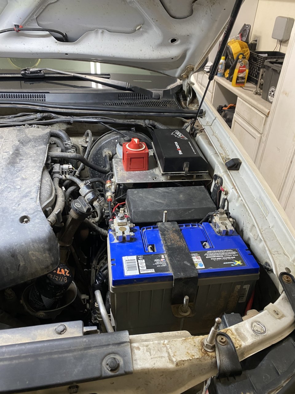

    I run mine 24 7 on a single battery set up. Optima yellow top, 55ah. The fridge is the iceco vl45. Solar panel is the 85w cascadia 4x4 panel.
    Been doing it for months now with zero issues. It's run straight to my voswitch but I also have a bluesea panel in the bed for when I need the room for the dogs.

    I run my fridge off a single 27f AGM battery with no issues. It can run for a few days no problem in hot weather without starting the truck. I originally considered solar but after using the fridge some I've found no need for it. I'm never setting up camp and sitting in place for a week at a time.

    This is basically what I do but with an upgraded deep cycle battery due to my high power draws of the winch and lights I have. One big battery, solar panel on the roof to keep it topped off and the ARB hardwire kit off of the battery. Simple, fairly inexpensive and reliable.

    I have a basic 12V setup to run my IceCo VL45pro fridge. Deep Cycle RV battery from Wal-Mart in a battery box. NoCo Gen 1 Mini charger to recharge off the power inverter or wherever I can find an outlet. Ran like this for 10 days in the fall in Utah and never dropped below 70%.
