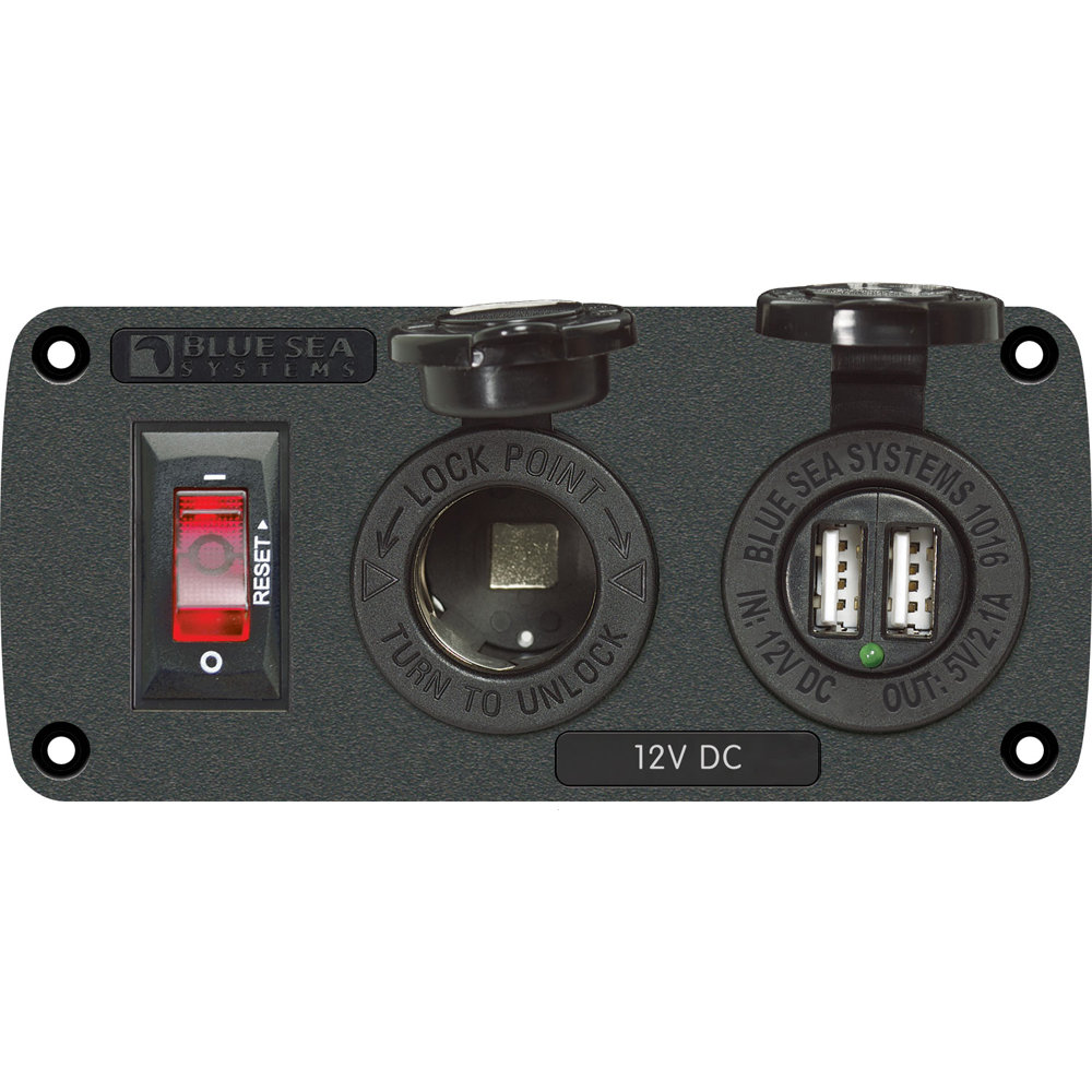

    I wouldnt run a fridge off a switch pro. Yes, itll do it, but would be much better/easier to run straight off the battery using a blue sea 12v plug panel and the 12v cig plug wiring harness. Plus it gives you an extra switch output for lights, etc.

    Upside of the 12v panel is you can get it with things like a battery voltage monitor or usb outlets for charging a phone, etc while you hang out around the tailgate. Also comes with the benefit of a power switch so, again, makes the need for a standalone switch unnecessary. 9100 would totally do the job, just trying to offer an alternate layout.

    Thanks for sharing a photo of this, so I would run this 12v panel from the battery, to the bed of the truck, do I need my own wire for this? What gauge would be best? I just ordered some 12ga wire. And then I would use the cig lighter power cable the fridge comes with and plug that into the 12v panel and I am all set? Then I can remove the fridge when not in use and where should I mount the panel at? Any ideas? thanks again man
