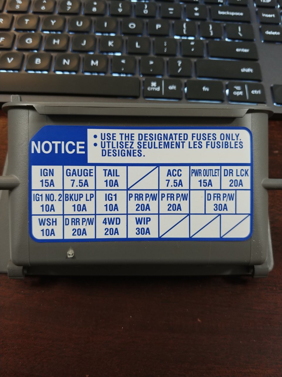

    So this is a random question.. Why does the drivers front window have a 30A fuse? The other three have a 20A fuse. Assuming Im interpreting the D FR P/W label correctly.

    Because at the drivers switch panel you can activate more than 1 window at a time.

    Driver switch controls all windows. Other switches only control one.

    Are the actuators relay'd through the door switches? Or do the switches directly control the actuators?

    There’s only 1 relay for the PWs. It’s on the back of the fusebox to supply power to the whole system when the key is on. I soldered mine shut so the PWs work anytime. There’s a single LED in the drivers switch panel that stays on all the time but it’s not enough draw to run the battery dead. The switches directly control the motors.

    Seems odd then that they would use a 30A for the entire system, but 20A each for the 3 separate ones..

    Yeah, it is, but that’s the way they did it. Obviously 20A is way overkill for each individual circuit.
