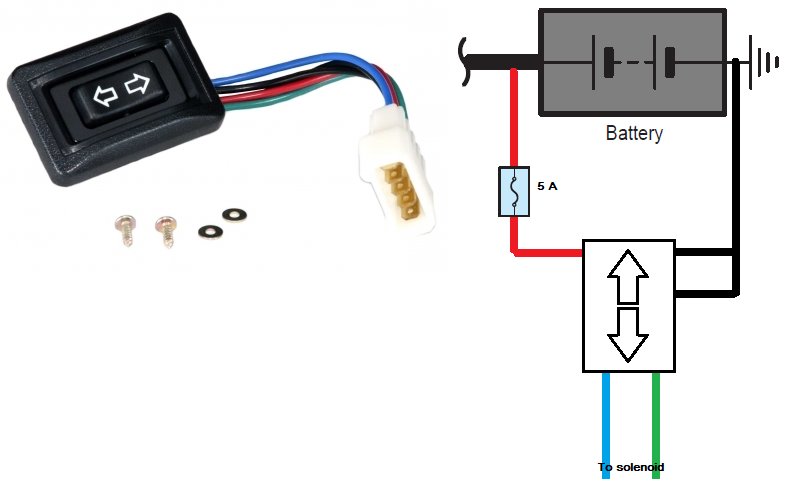

    Could've done this:
    And have the Tailgate lock with all doors. Just the unlock on a switch...
  8. May 5, 2019 at 10:26 AM

    No, that's not what I am showing. The unlock has it's own switch. The lock is the one tied into the vehicle lock system.
