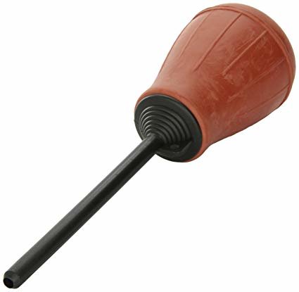

    This isn't helping the OP. But as a little preventive maintenance...I do a suck and fill of the reservoir at every oil change with Valvoline Maxlife.
    Years ago I bought a battery syringe from Autozone for about $5. It's perfect for doing a fluid swap.
