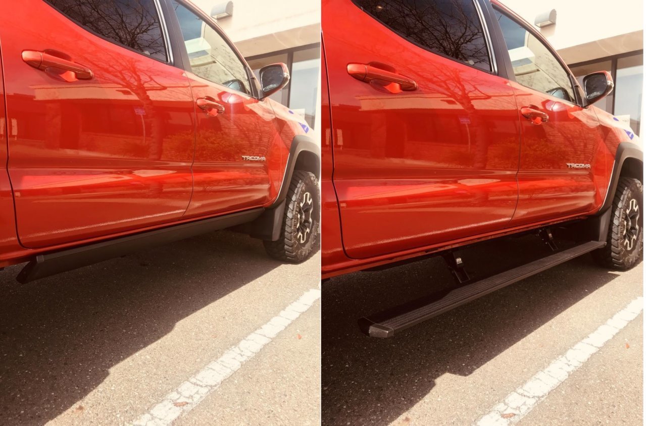

    I don’t have a numerical measurement. I went with these cause they are way lower that non-electric steps. Here’s a picture with the steps in the “up” and “down” positions.

    I got this for much the same reason. Wife is short, dad has bad hips, and my joints are getting worse by the day. Needed something a bit lower.

    Thanks for the info, they do appear to be lower than what is currently on my Tacoma. Has anything changed to rethink you getting these? I’m getting closer to making a decision…

    Same here. Wife had a hard time getting in, especially with a tight skirt.

    Nope, I love them. I have had them for a couple of years and I daily drive. They work great. They are also great for washing the truck.
